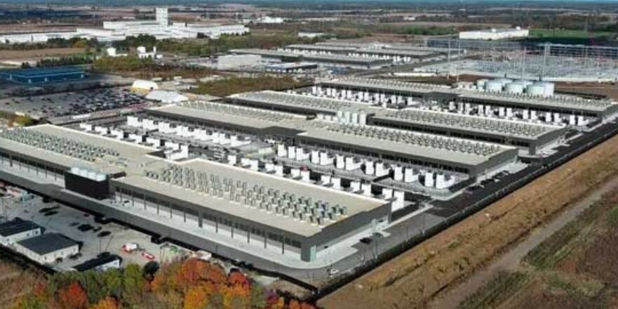

When you’re replacing Alexa or Gemini… This is what you’re ACTUALLY replacing…
^^^ That’s a Ranier datacenter. The fact I can almost run locally on a single 5070ti is absolutely astounding tbh.
