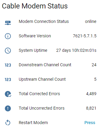

Screenshot
Dashboard view showing all key metrics:

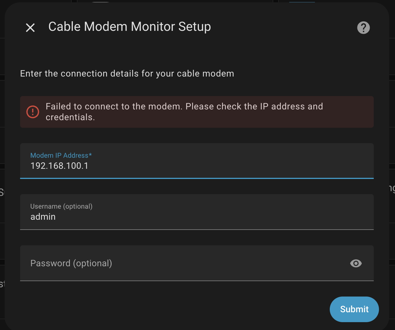

I’m trying v1.6.0 against my old but trusty ARRIS SB6141. It is at the default 192.168.100.1, and answers via HTTP from a local computer’s web browser. I can also nc to the cable modem’s port 80 successfully via a HA shell prompt, as well as traceroute to it with one hop through the router/firewall and then the cable modem.
The integration refuses to configure, throwing this error:
Failed to connect to the modem. Please check the IP address and credentials.
There are no credentials needed to access the modem’s web status interface.
Any suggestions???
Thanks for trying out the Cable Modem Monitor integration with your ARRIS SB6141! I’ve done some research on your modem model.
The Good News: The error you’re seeing is not actually an authentication issue. The integration correctly handles modems without credentials (like yours), so it’s skipping the login step.
The Real Issue: The SB6141 is an older ARRIS SurfBoard model. While ARRIS acquired Motorola’s cable modem business and many models share similar web interfaces, the HTML structure on the SB6141 likely differs just enough that our parser can’t extract the channel data. When it fails to parse any channel information, it returns “unreachable” status, which triggers the connection error.
What We Need: To add proper SB6141 support, I need to see the HTML structure from your modem’s status
page. Could you help by:
  1. Opening 192.168.100.1 in your browser (or whichever page shows downstream/upstream channel data)
  2. Right-click → “View Page Source” (or press Ctrl+U)
  3. Save the HTML file (Ctrl+S)
  4. Important: Sanitize any personal info (MAC address, serial number, public IP) - signal data itself is fine to share
  5. Either attach it here or create a GitHub issue:
    Sign in to GitHub · GitHub
I’m also pushing an update today that will improve error messages and make the UI clearer about optional authentication. Once you share the HTML sample, I can add SB6141-specific support!
http://192.168.100.1/cmSignal.htm

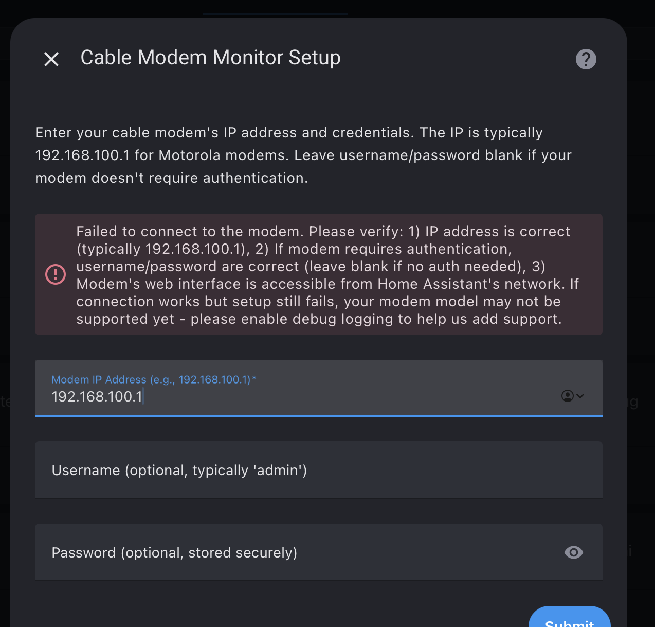

that was fast… Thank you! I tried this but i also get the following error after entering username and password:
Thank you, Ken. That was quick!
It is displaying 57 entities. All of the channel info and stats are being populated and appear sane compared to the modem’s management web page.
However, Software Version and System Uptime are both coming up as Unknown. I guess this should be expected, since neither of those values were on the page that I provided with the channel data. I don’t anticipate ARRIS ever shipping another firmware update for the SB6141, so that’s not a problem. I was thinking that the uptime could be really useful for automations, but thinking about it some more I would probably want the last boot time and that’s not being shown on any page (not to mention that the clock isn’t synched in the modem for some reason and is off by hours and minutes).

  • :camera_flash: Screenshots welcome! Would love to see your dashboards/entities
