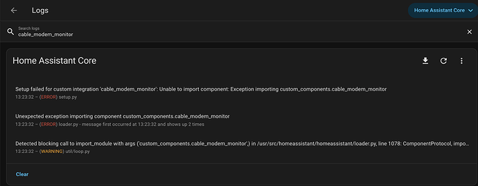

There’s a problem with v3.10.1 (with SB6141 if it matters). It is reporting an invalid config after rebooting following this latest update:
Logger: homeassistant.util.loop
Source: util/loop.py:77
First occurred: 13:23:32 (1 occurrence)
Last logged: 13:23:32
Detected blocking call to import_module with args ('custom_components.cable_modem_monitor',) in /usr/src/homeassistant/homeassistant/loader.py, line 1078: ComponentProtocol, importlib.import_module(self.pkg_path) inside the event loop; This is causing stability issues. Please create a bug report at https://github.com/home-assistant/core/issues?q=is%3Aopen+is%3Aissue For developers, please see https://developers.home-assistant.io/docs/asyncio_blocking_operations/#import_module Traceback (most recent call last): File "<frozen runpy>", line 198, in _run_module_as_main File "<frozen runpy>", line 88, in _run_code File "/usr/src/homeassistant/homeassistant/__main__.py", line 229, in <module> sys.exit(main()) File "/usr/src/homeassistant/homeassistant/__main__.py", line 215, in main exit_code = runner.run(runtime_conf) File "/usr/src/homeassistant/homeassistant/runner.py", line 289, in run return loop.run_until_complete(setup_and_run_hass(runtime_config)) File "/usr/local/lib/python3.13/asyncio/base_events.py", line 712, in run_until_complete self.run_forever() File "/usr/local/lib/python3.13/asyncio/base_events.py", line 683, in run_forever self._run_once() File "/usr/local/lib/python3.13/asyncio/base_events.py", line 2050, in _run_once handle._run() File "/usr/local/lib/python3.13/asyncio/events.py", line 89, in _run self._context.run(self._callback, *self._args) File "/usr/src/homeassistant/homeassistant/setup.py", line 170, in async_setup_component result = await _async_setup_component(hass, domain, config) File "/usr/src/homeassistant/homeassistant/setup.py", line 343, in _async_setup_component component = await integration.async_get_component() File "/usr/src/homeassistant/homeassistant/loader.py", line 1030, in async_get_component comp = self._get_component() File "/usr/src/homeassistant/homeassistant/loader.py", line 1078, in _get_component ComponentProtocol, importlib.import_module(self.pkg_path)
Well that’s not good! I actually picked up a 6141 this week from a friend. I’ll take a look later today and post an update once I know more. Thanks for posting!
If it winds up being an issue with the 6141 and not every other modem as well, I would be fine with deprecating it from the integration because it is grossly obsolete at this point and not worth the effort to maintain…
Hey vreihen, good to see you again!
Thanks for reporting this. You actually caught two issues:
  1. The blocking import warning you saw - that’s real, and fixed it by moving deferred imports to top-level.
  2. A much bigger problem - I ran BFG Repo-Cleaner to sanitize some passwords from our test fixtures (HTML captures that contributors submitted from their modems), and it went catastrophically wrong. The tool replaced every # comment character with REMOVED, breaking the entire v3.10.1 release with syntax errors. Lesson learned the hard way, and of course it happens when I don’t follow my own discipline.
v3.10.2 is out now and fixes both. Also deleted v3.10.1 entirely so nobody else can install it.

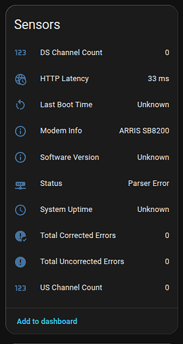

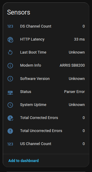

I just installed this integration to get the data from my SB8200v3. The sensors for Last Boot Time, Software Version, and System Uptime are showing as UNKNOWN. The status sensor is showing PARSER ERROR. Any idea on how I can fix this?
Thanks in advance.
Hi Rob! Thanks for the report. The SB8200v3 is a variant I haven’t seen, which likely explains the UNKNOWN sensors (the HTML structure probably differs from what the parser expects).
I’ve been reworking the auth layer in the v3.12 branch to handle variant edge cases better. If you’re comfortable installing from a feature branch, give feature/v3.12.0 a try—if you’re still seeing issues, Sign in to GitHub Ā· GitHub with the diagnostics download attached and I’ll use that to add support for your variant.
FYI, this is a side project so response time varies and I’ve got a bit of a backlog. Optimistic this new auth process does the tricks but either way I’ll do my best to work with you to get your modem running.
