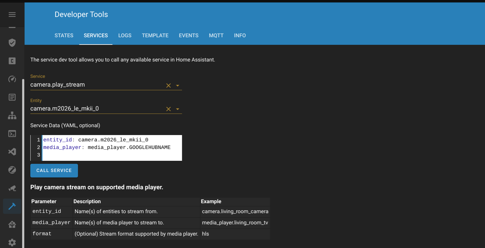

Try this:
After selecting camera.play_stream for the service call you should see your camera in the entity drop down list.
Add the line for what media player to play the stream on and replace “GOOGLEHUBNAME” with the name of your hub in home assistant.
I have the original hub display, but this should work for any google device that is “cast” compliant with a screen.

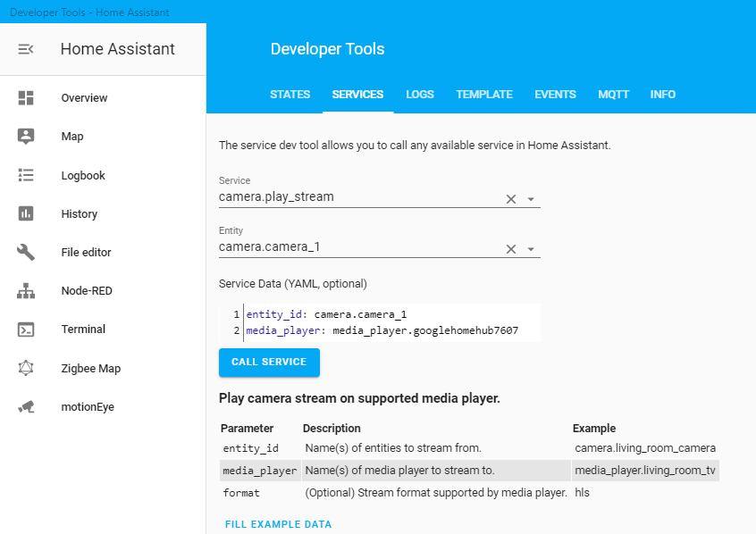

This looks much easier. Unfortunately it is not working for me. When I try this I get a black screen on my Google Home Hub with the message “Playing Default Media Receiver” above the video slide bar and a Pause button ( || ). I can click pause and play to no effect.
Here is my camera definition from my configuration.yaml file.
ffmpeg:
    ffmpeg_bin: /usr/bin/ffmpeg
stream:
camera:
   - platform: ffmpeg
    input: -rtsp_transport tcp -i rtsp://dvruser:[email protected]:554/ch01/0
and my service call is:
rtsp://dvruser:[email protected]:554/ch01/0 streams correctly when viewed with VLC player and in motionEye.
I am hoping that you may have seen this behaviour before and may know the solution.

Yes and at your suggestion I tried this:
ffmpeg:
    #ffmpeg_bin: /usr/bin/ffmpeg
stream:
camera:
  - platform: ffmpeg
    input: -rtsp_transport tcp -i rtsp://admin:[email protected]:554/ch01/0
    extra_arguments: -pred 1 -q:v 2 -s 1024x600
  - platform: ffmpeg
    input: -rtsp_transport tcp -i rtsp://admin:[email protected]:554/ch01/1
ie setting the resolution to match the resolution on the Google Hub and also using the low resolution stream provided by the DVR/Camera. Neither worked.
I am currently trying to work out how to access ffmpeg from the command line in HassOS. It is supposed to be a built-in integration so I assume that it is running in the HA container but can’t work out how to access this. You will also note that I have commented out the second line of the the ffmpeg: section in configuration.yaml. I believe that this is only needed if HA is running in Rasbian or some other Linux platform.
