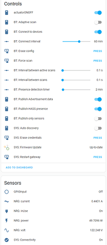

The rapid detection of current change has been implemented in firmware version 1.6.0 of the Theengs Plug
Every 0.5s, the current is checked, and if there is a value change of more than 0.1A, the energy consumption values are reported.
This will enable triggering automation based on the connected device state.
