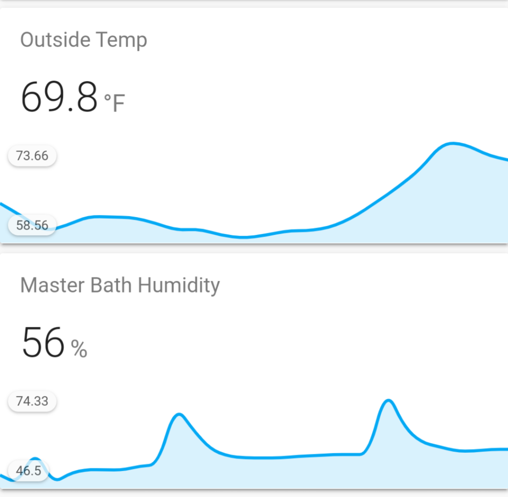

I have the weather displayed on my dashboard. But can I chart the temperature and humidity values from that component? I’d need to store them every half hour or what ever. Is this possible?
Sure, if those are states (you can make them states by using a template sensor if they’re attributes) you can use a history graph card.
That looks like exactly what I want. I don’t have a sensor thought. I was hoping to get the data from the “built in” weather card I have, which I didn’t add - so assume it’s a default weather provider.
Edit! Ah! I read that incorrectly. I read “temperature sensor” but you said “template sensor”. So I can somehow read the data from the weather plugin into the template sensor. And then get the data from the template sensor?
I’ve had great success with this: https://github.com/kalkih/mini-graph-card
Yes. Look in Developer tools -> States
You can see every entity, and their attributes, in there. For my setup, where I’m using weather.dark_sky I could pull that into a template sensor with:

That will create sensor.current_temperature that you can graph. Check your own entities and attributes to see what will work for you.
