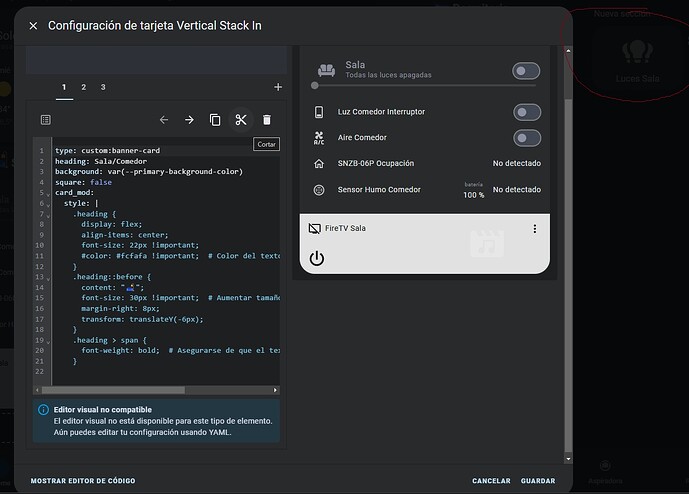

Cannot read properties of undefined (reading 'get Config Element')
I have the following error in the dashboards, I don’t know why it is caused. But if I add any new card it is solved momentarily, if I reload the page again, the error returns.
Something similar happened to someone, what could it be?
thank you
with error
with no error

Thanks. Here’s your issue:
  - type: entities
      - type: custom:hue-like-light-card
You are trying to use the hue-like-light-card as a row element of the entities card. This is not supported by the custom card.

I have the same error, only dissapear if i agree one more ramdon card in the dashboard is strange
Save the whole card config somewhere. Then remove the cards from the stack one by one until the error disappears. Which card is causing the issue?

i delete one by one in stack and the error persist
Then it could be the stack-in card. Try testing the core vertical-stack card instead.
Looks like there have been no updates for 4 years and there are many open issues. GitHub - custom-cards/stack-in-card: 🛠 group multiple cards into one card without the borders I would not use this.
For similar stack-in functionality I use entities cards with the previously linked hui-element card to allow adding anything as a row.
yes! the stack-in card was the problem, I will look for another solution, thank you very much!
