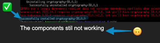

Thanks Mike but no luck.
At first i tried for 38.0.1
But HA shows the same notification about the not working components
After that i tried for 38.0.0
The components stil not working
CleanShot 2022-10-11 at 15.05.17
Don’t be fooled by the red warnings/errors shown, with the legacy resolver pip will just continue to do what you asked for…
It should just start now.
