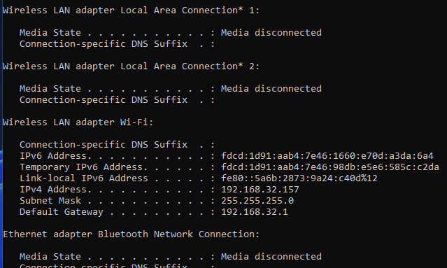

And here’s the info when I unplug the ethernet cable, turn on wi-fi and connect to it:

It seem to be on the same IP range:
  • Client PC Connected via Ethernet ipv4 IP 192.168.32.206
  • Client PC Connected via Wi-Fi ipv4 IP 192.168.32.157
  • Host PC Connected via Wi-Fi ipv4 192.168.32.162
  • Virtual Box IPV4 address 192.168.32.62/24
