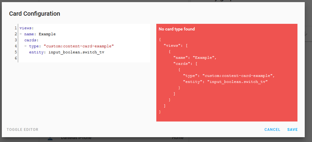

If i go to the UI trying to add a manual card i only get:
I have tried many variations, the main problem is, that I have not found any kind of “migration guide” which explains how those configurations are working toghether. Any help is very much appreciated.

Adding the card in the GUI is what I’m trying to do. I don’t really understand the question cause you can see that I’m posting screenshots of the UI editor? Let’s try to keep things simple, this is the 1:1 example from the developer documentation - so whats wrong here:
“No card type found” == you are missing type: "custom:content-card-example" in your card config.
I don’t understand? Did you take a look at my last screenshot. Line 7:
  - type: "custom:content-card-example"
that card does not exist
No…
You have more issues…
You are trying to paste your entire lovelace config in a card configuration, don’t do that :wink:
Go to the menu at the top right, then select raw editor and paste the same thing there.
Halleluja, I think this was the key hint i needed. :smiley: I have never clicked at the three dots after clicking at “Configure UI” so I did not know the Raw Editor. So my hole config looks like that now:

Inside the view “Monitoring” I have now the custom card. Do I have to use the Raw Editor now every time? Or can I add a custom card also via > Add Manual Card? If it is also possible via “Manual Card” what do I have to paste there?
You can define cards with manual card, but you need to add resources with raw editor.
This would work as a manual card:
entity: input_boolean.switch_tv
Perfect - this works. Thanks guys for your patience! :slight_smile:
