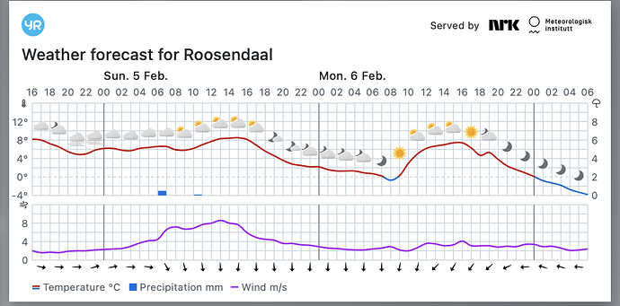

just found a card_mod I dont think that has been posted here yet:
  - type: picture-entity
    card_mod:
      style: |
        ha-card {
          {{'filter: invert(100%)' if is_state('binary_sensor.dark_outside','on')
             else 'filter: none'}} ;
    show_state: false
    show_name: false
    entity: camera.weer_roosendaal
turning day card/light:
into night/dark:
which I find to be exactly what I was looking for :wink:
well, except for the color of the sun ofc, but hey, that’s a minor detail…

this is a generic camera integration entity,
SchermĀ­afbeelding 2023-02-05 om 13.52.08
made on the
https://www.yr.no/en/content/2-2747930/meteogram.svg resource.
if you go there you find your own region and save thathttps://www.yr.no/en
