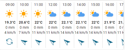

Hello, I am trying to see how I can scroll horizontally through weather forecast information.
I have a realtively standard card with which I can display (say) 25h of forecast. If I present this via panel it shows fine but I would like to have this as part of a regular dashboard (stack).
Is it possible to scroll horizontally through something like this?
