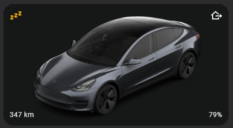

I have a state-icon within a picture-elements card. I’d like to customise the colour of the icon depending on its state. I want to use some custom colours, and not the ā€˜dashboard-wide’ colour scheme that HA is trying to force me into.
This is my base card (sorry about the non-reproducible image…)
I’m just trying to change the colour of the ā€˜sleep’ status in the top left corner as a starting point.
  - type: picture-elements
    image: /local/model_3_grey_wide.png
    elements:
        - type: state-icon
          entity: binary_sensor.asleep
          icon: mdi:sleep
          style:
            top: 1%
            left: 1%
            transform: none
It looks like (using the inspector) that the var(--state-binary_sensor-active-color); is responsible for the colour, but I’d like to change it to an arbitrary value (e.g. a hex code).
My attempts at changing the colour have all ended in failure. Any helpful hints appreciated!
