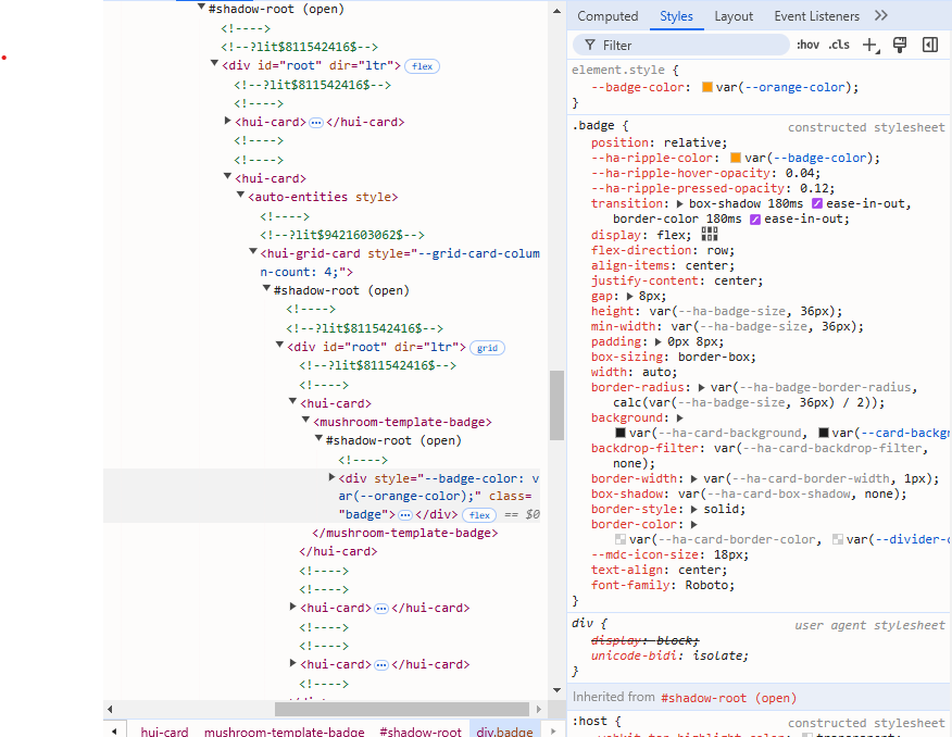

Can someone remove the Padding from a mushroom badges?
i need access to .badge {
I’m trying to write a single loop that conditionally changes the formatting of an entities list. I’ve got as far as being able to loop over the entities and correctly pick out the corresponding elements.
