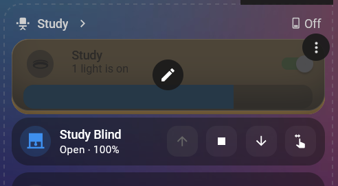

Would this work on the card, substituting the desired value:
ha-card {
margin-bottom: -4px;
Note the difference in spacing between the light card and cover card compared to the cover card and the next card.

I had similar probâŚ
I could fix it with row height:
grid_options:
columns: 12
rows: 0,5
Ya can try to play with thisâŚon your desired columns and row heightâŚ
In the layout optionsâŚ
Hope this helps you tooâŚ

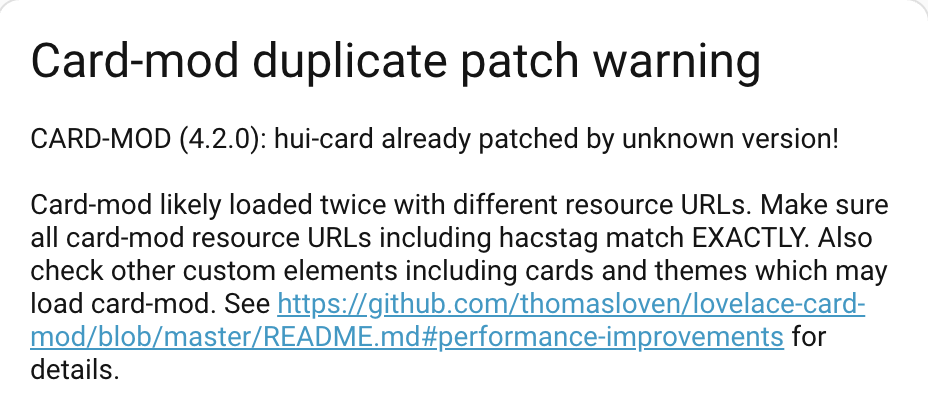

Card-mod duplicate patch warning
I received a notification re Card-mod duplicate patch warning as follows:
Iâve read through the link provided but I am uncertain about what to do.
Looking at the resources page I see this entry:
/hacsfiles/lovelace-card-mod/card-mod.js?hacstag=190927524420
I gather I am asked to create a configuration.yaml entry like this:
frontend:
extra_module_url:
- /hacsfiles/lovelace-card-mod/card-mod.js?hacstag=190927524420
I noticed I already have this in my configuration.yaml
extra_module_url:
- /local/community/lovelace-card-mod/card-mod.js
Should I replace my earlier entry with the one with the hash code? Or do I use both?
Also if I place the one with the hash code in configuration.yaml, do I delete it from the resource list?
Thanks for any advice.
This is the issue and you need to replace with the Dashboard resource URL /hacsfiles/lovelace-card-mod/card-mod.js?hacstag=190927524420 then reboot Home Assistant.
If you donât use CAST, yes you can remove Dashboard resource URL, but if you use HACS it will return next time you upgrade. So the recommend approach is to keep both, and update extra_module_url when you update card-mod.
Does the hacstag change with each revision to card_mod, requiring configuration.yaml to be updated too?
Yes. hacstag changes on each update. For single digit revisions it is the last 4 digits of the hashtag. The first 9 is the GitHub repo ID for card-mod.
Confirming configuration.yaml needs updating on each revision as is noted in the release notes.
Thanks, I donât know what CAST is, so I guess I just update the configuration.yaml entry and leave the rest alone.
