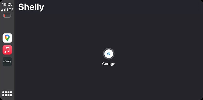

Digging this up… Shelly app just got carplay support so seems apple is giving that entitlement to more apps than navigation, music and such!

I have some Shelly devices but none is showing up in the app. The app is saying please configure devices in the app settings but there is no such setting for my plugs,1pm or em3.
In the Shelly app, under preferences → CarPlay you can activate which entities you want to add to CarPlay.
I second this, shelly now works in carplay. devices can be selected in the shelly app for carplay. I hope the same will be added to Homeassistant soon
This image was added to Shelly’s FB group by the Dimitar himself (the CEO).
It doesn’t seem to fit in any of the categories mentioned but they still got it… Either Apple is loosening their restrictions or they got a special favour for wtv reason. I really doubt they granted the CarPlay entitlement to Shelly by accident.
