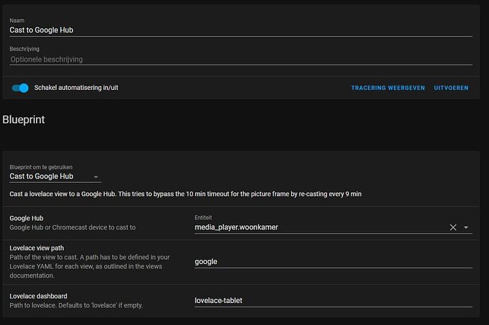

Cast and re-cast a lovelace view to a Google Hub
Hello everybody,
i still use the Cast since 3 Month and i love it.
But since a few days i have the problem that everytime
cast will re-cast (every 9 min) i get a pling on my Google Hub.
The Volume is 0 and the alarm too.
thats realy Annoying every 9 min pling
have anybody the same problem and is there a solution?
Thanks for the help and sunny greatings
Diver

2021-07-10 20:00:00 WARNING (MainThread) [homeassistant.components.automation.tiene_attivo_schermo_cucina] Continua a visualizzare percorso su google hub cucina Blueprint: Already running
Thanks for share it! however, can you explain why the automation says ā€œAlready runningā€?
