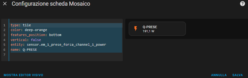

Good day to everyone, sorry but i not abe to fully understand how to apply what you say to my case.
My case:
I would change color according to range of consumption of my devices.
here is the actual tile for example:
type: tile
color: deep-orange
features_position: bottom
vertical: false
entity: sensor.em_1_prese_forza_channel_1_power
i would let it green until is higher than 200w, blue until 1000w, orange until 2000w and red above 2000.
Tnx
Using this is not needed here since card-mod supports jinja.
You need to use card-mod.
Examples are here: main card-mod thread - 1st post - fantastic link at the bottom - tile card
Tnx i found the main card-mod thread, but i dont find any similar case… (probably i cannot understand) can you please point me an example or devlop my own example?
Please ask all card-mod related questions there.
The path to a list of styles for Tile card was provided above.
