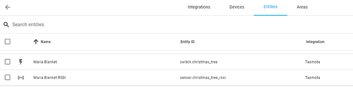

I moved a Tasmota plug from the christmas lights over to a heated blanket. I renamed the device in Tasmota accordingly:
The change has been reflected in Home Assistant, but only for the Name, not for the Entity ID:
This is confusing because it’s the entity ID that I need when configuring views and automations.
How do I change it?

Ah, never mind, I found it.
I have to click each enabled entity and there I can change the ID:
You got it :wink:
I discovered (no pun intended) another method. If I simply delete the device and and restart the Tasmota plug then it will come back and all its entities will be generated from the new name.
My naming was a mess as, I’m guessing, it picked up the ‘tasmota’ friendly names before I had time to change them.
Anyway, all sorted now. I did have to restart the devices after deleting them.
