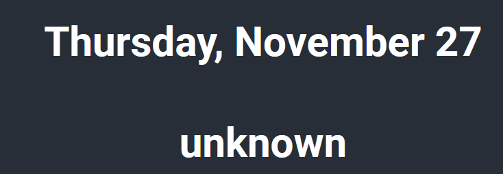

Thank you, I’ve applied your code and the editor complains about the indentation of template:
I tried changing the indent but it is probably wrong according to the rest of the code in configuration.yaml
Edit:fixed the indentation but the date number (today 27) and time stopped working and shows as unknown unknown.
Edit two: got the date to show, today is the 27. Now only the actual clock time dissapeard. This is the code in raw configuration:
              - type: markdown
                content: |
                  # <center> <font size='9px'> {{states("sensor.time")}} </center>
I have no reference to the time in configuration.yaml
You can use
{{ now().timestamp() | timestamp_custom("%H:%M")}}
Or add the time integration in devices and integrations under settings

Thank you. Now everything works on the first page of the tablet.
