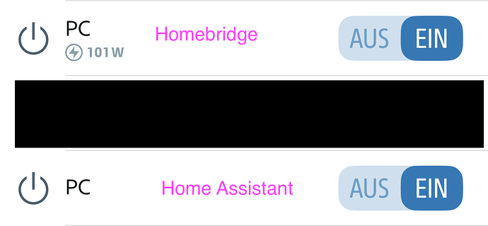

Sorry for reviving this old thread, but thanks to your help I was able to figure out how to change my switches to outlets. I totally overlooked this method in the documentation.
But now I have another question. When using homebridge to expose my zigbee outlet to HomeKit, it also shows the current power and the overall energy consumption of an outlet. While not in the Apple home app, it is visible in other HomeKit apps like Eve for example. Is there a possibility to achieve the same with home assistant?
I attached a screenshot to show what I mean. The PC device is the same physical device, one time connected via a homebridge mqtt plugin and one time via the home assistant homekit configuration.
