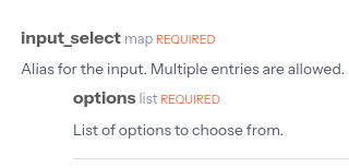

Why “seems”… it’s documented that only a list is accepted:
If templates were accepted it would say template next to “options”, not list.
If you want to use a template to define the options, you need to use a Template Select.
