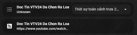

I have bellow template select
- select:
    - name: "Doc Tin VTV24 Da Chon Ra Loa"
      unique_id: select_doc_tin_vtv24_da_chon_ra_loa
      state: |
        {{states('input_text.doc_tin_vtv24_da_chon_ra_loa')}}
      options: |
        {% set video_entries = state_attr('sensor.vtv24_youtube_channel','entries') |sort(attribute='published', reverse=true)%}{% set video_titles = video_entries |map(attribute='title') |list %}{{video_titles}}
      select_option:
        - service: input_text.set_value
            entity_id: input_text.doc_tin_vtv24_da_chon_ra_loa
            value: |
              {% set selected_title = option %}
              {% set video_urls = video_entries |map(attribute='link') |list %}
              {# Chọn tiêu đề cần tìm URL #}
              {% set index = video_titles.index(selected_title) if selected_title in video_titles else -1 %}
              {% if index != -1 %}
                {{ video_urls[index] }}
              {% else %}
                Không tìm thấy tiêu đề trong danh sách!
              {% endif %}
      availability: "{{ states('input_text.doc_tin_vtv24_da_chon_ra_loa') is defined }}"
      optimistic: true
Why states of select alway unknown when i changed option
State of input_text has changed.

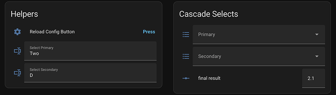

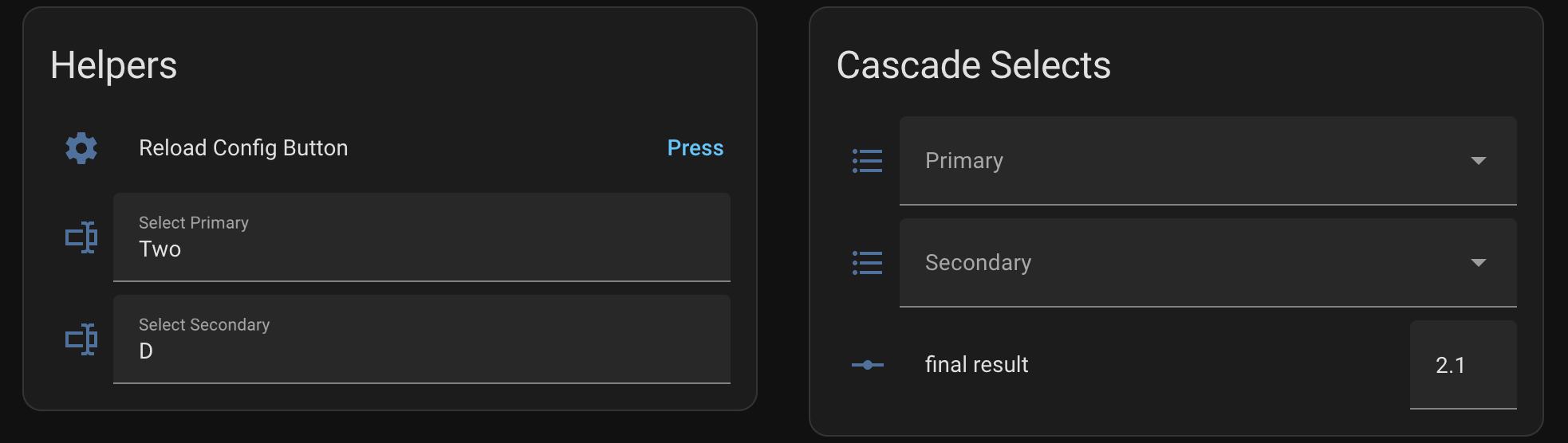

I switched from using input_selects to templates, partly because of this thread, but also because I’m having a UI issue I was hoping using template selects might address.
After restarting home assistant sometimes (not always) the UI isn’t refreshed and that leaves the selects (as well as input_selects) in the UI blank – event though the states are updated in dev console and refrshing the browser shows the correct states.
I do trigger on HA restart to refresh the select. I use a separate input_text to store the state of the select.
I’m curious if anyone else is seeing this. Not a huge deal as can simply refresh the screen.
  - triggers:
      # Trigger on restart to restore state
      - trigger: homeassistant
        event: start
      # Allow something external to update the select
      - trigger: state
        entity_id: input_text.select_primary
    select:
      - name: Primary
        unique_id: select_primary_id
        optimistic: true
        state: "{{ states('input_text.select_primary') }}"
        options: "{{ state_attr('sensor.select_config','primary') }}"
        select_option:
          - action: input_text.set_value
              value: "{{ option }}"
I just now restarted and notice how the “Cascade Selects” are blank? (dev->states show that they do have the expected states.)
I see in the docs template selects have an optimistic mode now. Does this also survive restarts?

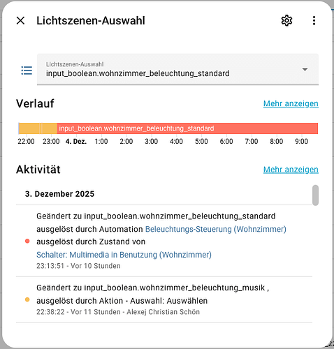

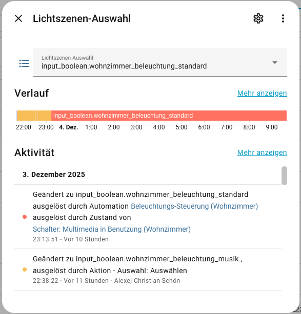

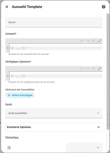

I have several input_booleans and would like to use the suggested option “Template Selects in place of an automation.”
I used the .yaml example provided and created a template sensor in the file editor. This provides a selection helper that does exactly what it’s supposed to do: switch the individual input_booleans on or off:
Now I would like to use the UI to create the very same helper (better maintenance):
But I can’t get it to work.
I would also like to be able to customize the names displayed in the selection (instead of input.boolean_wohnzimmer_beleuchtung_standard, I only want “Standard” to appear there).
Can you help me with this? I’m not very familiar with yaml. I only have a rough understanding of what’s happening.
Here is my code:
- select:
      - name: "Lichtszenen-Auswahl"
        state: >-
          {{ (expand(this.attributes.options
          | select('is_state', 'on')
          | list) | sort(attribute='last_changed', reverse=1)
          | map(attribute='entity_id')|list)[0] or
          (expand(this.attributes.options) | sort(attribute='last_changed', reverse=1)
          | map(attribute='entity_id')|list)[0]}}
        select_option:
          - service: input_boolean.turn_on
              entity_id: "{{ option }}"
          - variables:
              boolean: |
                {{ this.attributes.options |reject('eq', option)|list}}
          - service: input_boolean.turn_off
              entity_id: '{{ boolean }}'
        options: >
          {{ states.input_boolean
          | selectattr('object_id', 'match', 'wohnzimmer_beleuchtung')
          | list }}
You’ll need to share what you have tried… a screenshot of the config flow that doesn’t have any of the fields filled out isn’t really helpful.
If all of your input booleans follow the same naming pattern you can use the map filter to get the “friendlier” value for options, but then you will then need to add back the rest of the entity ID in a number of places:
  - select:
        state: >-
          {%- macro prepend(root,pre) %}{{- pre~root -}}{%- endmacro %}
          {%- set opt_ents =  this.attributes.options|map('lower')
          |map('apply',prepend,'input_boolean.wohnzimmer_beleuchtung_')|list %}
          {%- set sorted_obj = opt_ents|expand|sort(attribute='last_changed', reverse=1)|list %}
          {{- (sorted_obj|selectattr('state', 'eq', 'on')|map(attribute='entity_id')|list)[0]
          or (sorted_obj|map(attribute='entity_id')|list)[0]}}
        select_option:
              entity_id: "input_boolean.wohnzimmer_beleuchtung_{{ option|lower }}"
          - variables:
              booleans: |
                {{- set opt_ents =  this.attributes.options|reject('eq', option)|map('lower')
                |map('apply',prepend,'input_boolean.wohnzimmer_beleuchtung_')|list }}
              entity_id: '{{ booleans }}'
        options: >
          {{ states.input_boolean | selectattr('object_id', 'match', 'wohnzimmer_beleuchtung_')
          | map(attribute='object_id') | map('replace', 'wohnzimmer_beleuchtung_','')
          | map('capitalize') | list }}

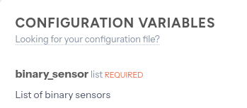

Both the integration key template and the different entity platforms under it, like binary_sensor, expect a list…
… so you can have multiple platforms as well as multiple entities of the same type sharing the same list of triggers as well as variables, conditions, and actions:
