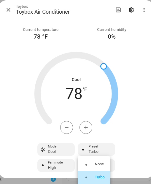

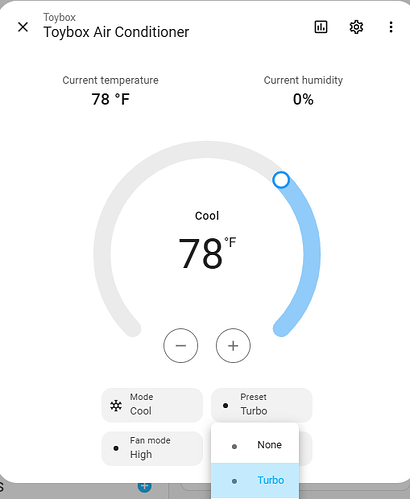

The author, bodyscape, does not officially support Mr. Cool, I was wondering if anybody here has tweaked the integration to make the “turbo preset” work? I see it in the logs when I change it from the Cielo website to turbo,
but when I use Home Assistant controls to try to set Turbo, it does nothing.
I think the issue is in the cielohomedevice.py, but I am struggling to troubleshoot it. Does anybody have a suggestion on where to start troubleshooting?
I believe I have found the issue. It is in the _send_turbo function in cielohomedevice.py.
       if (
            self.get_device_type_version() != "BI03"
            or self.get_device_type_version() != "BI04"
            value = "on/off"```
I believe the "or" should be "and".  As it is written, it will always be true.
