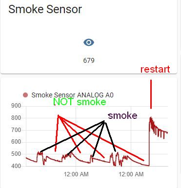

miguelromao, flashed an ESP it with Tasmonta, configured analog pin and connected the MQ-2 analog pin directly to the ESP. Unfortunately there are 2 issues:
  1. the sensor is not that sensible to smoke. Is sensitive to Gas
  2. the refresh is not instant in HA, it has a delay of 2-3 min until HA get’s the new value.
    Did you use other electronic components for your sensor, to make is more sensitive. My sensor sits at ~800 value and goes to 1024 when I put some gas from the lighter 2-3CM close to it.
I have done some more digging and realized that the best solution is the expensive xiaomi air quality sensor. Design for continues and fast sensing of air quality using laser technology.
  • the MQ line of sensors are not sensitive to smoke, here is my graph for 3 days, you can clearly say from the graph when smocking was done in the room but is not instant and the range is to narrow for an automation, and it takes one day to settle down in a normal range, see spike at the end.
