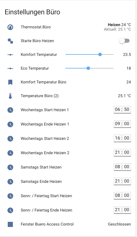

i have an automation problem with my time scheduling the thermostats over the day.
I use the eurotronic zwave thermostats and set some input_number’s and input_datetimes to control them. This is the first step, it should become more complex later :slight_smile:
the first pic shows the frontend and my inputs
then the automation code
and a screenshot which shows the replacements.
i have no ideas anymore

Your automation is wrong in multiple places.
First when should your automation trigger? You specify only the platform but no time to trigger. You probably want it to trigger at your specified start times.
Second, you can’t template “after” and “before” in your conditions.
I think you need to rethink how you do your automations and read the docs (again).
