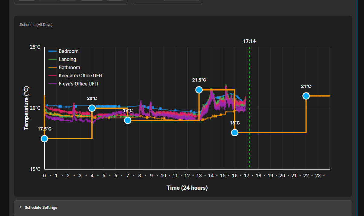

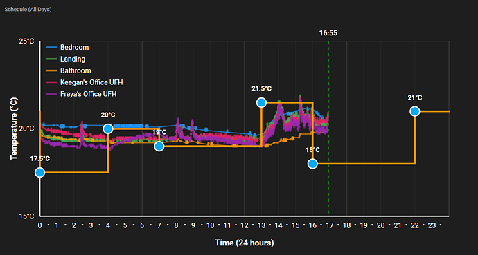

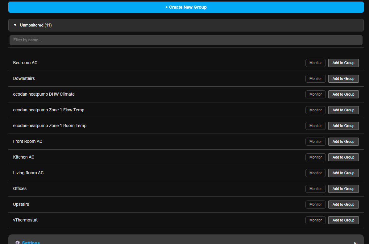

Click on “Unmonitored” to see a list of all the climate entities in your HA instance, you can click “Monitor” to add the entity by itself or if you have groups created already “Add to group” will do just that.

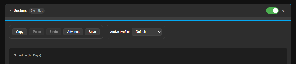

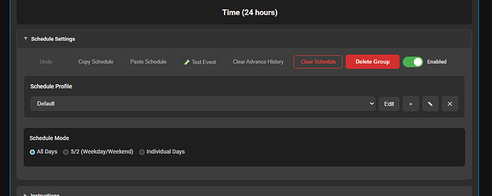

At the top of each schedule you should see a few controls, you can enable/disable the schedule, choose which profile is active, copy/paste, or advance the schedule to the next node. This may be useful in case you come home early and the heating isn’t due to be on for a while. You can cancel the advance if needed too.

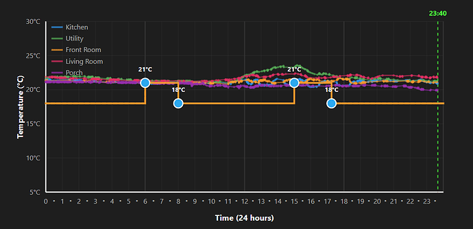

Each schedule presents with a graph, double clicking will add a node which you can drag around to set the time and temperature. If you click on the node you’ll see more settings which can be applied (below) such as HVAC settings or profiles, as well as “No change” which removes the temperature setpoint, this is useful for systems that don’t have temperature settings but rely on profiles instead.
The temperature for each member entity will also be displayed in the background, this can be disabled in the global settings for the integration at the bottom of the page.
For each schedule you have some options, these include the mode (24 hour, weekday/end, or 7 day) as well as creating or selecting a profile to edit. You can also copy or paste schedules to make it easier to duplicate then tweak for different areas.

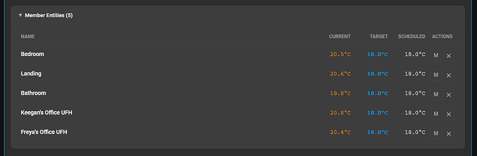

At the bottom of each schedule you can see the member entities and have the option to remove them or move them to another group.

  • Entity Filtering: Climate Scheduler’s own entities are now filtered from unmonitored entity list
    • Entities starting with climate.climate_scheduler_ are excluded from the list
    • Prevents confusion from seeing integration’s own proxy entities

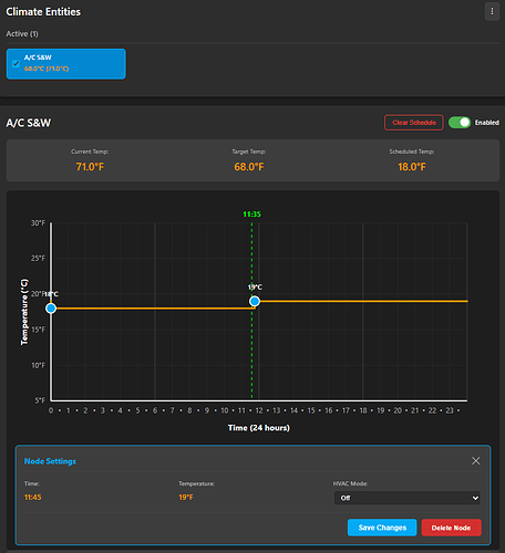

The conversion between C and F doesn’t work smoothly yet - happy to work with you on figuring it out in case you need some help here:
And, although I live in Fahrenheit-Country now, I grew up in the Celsius World.
Sometimes, I’m still struggling with the conversion, which is evident, that the temperature in my car is set to Celsius, while everything else is in Fahrenheit :stuck_out_tongue:
P.S.:
Happy to copy this over to a Github issue, if that’s where you’d like to see it.
I’ve pushed a fix for the unit issue, if you have a schedule set up already you’ll need to redo the schedules so that the new values are in the correct range. Fingers crossed it works!

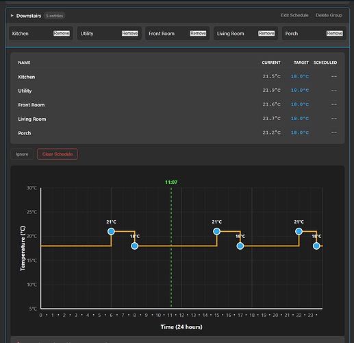

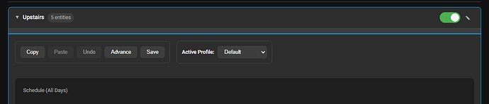

Updated to include basic group support.
Known issues:
  • Not functioning in the Home Assistant mobile app
  • Node editor allows for changing of HVAC and other settings, they aren’t currently applied to the device, only temperature is currently controlled
  • Scheduled isn’t updating properly, it should list the current scheduled target temperature and Target will show the actual value that device is set to. This is for cases where someone wants a bit more or less heat than scheduled. The scheduler should respect the change until the next node is hit, more testing is needed.
Version 1.0.3 pushed, it fixes an issue where it wasn’t working in the mobile app.
Fixed a few bugs, now showing temperature history for grouped and single thermostats:

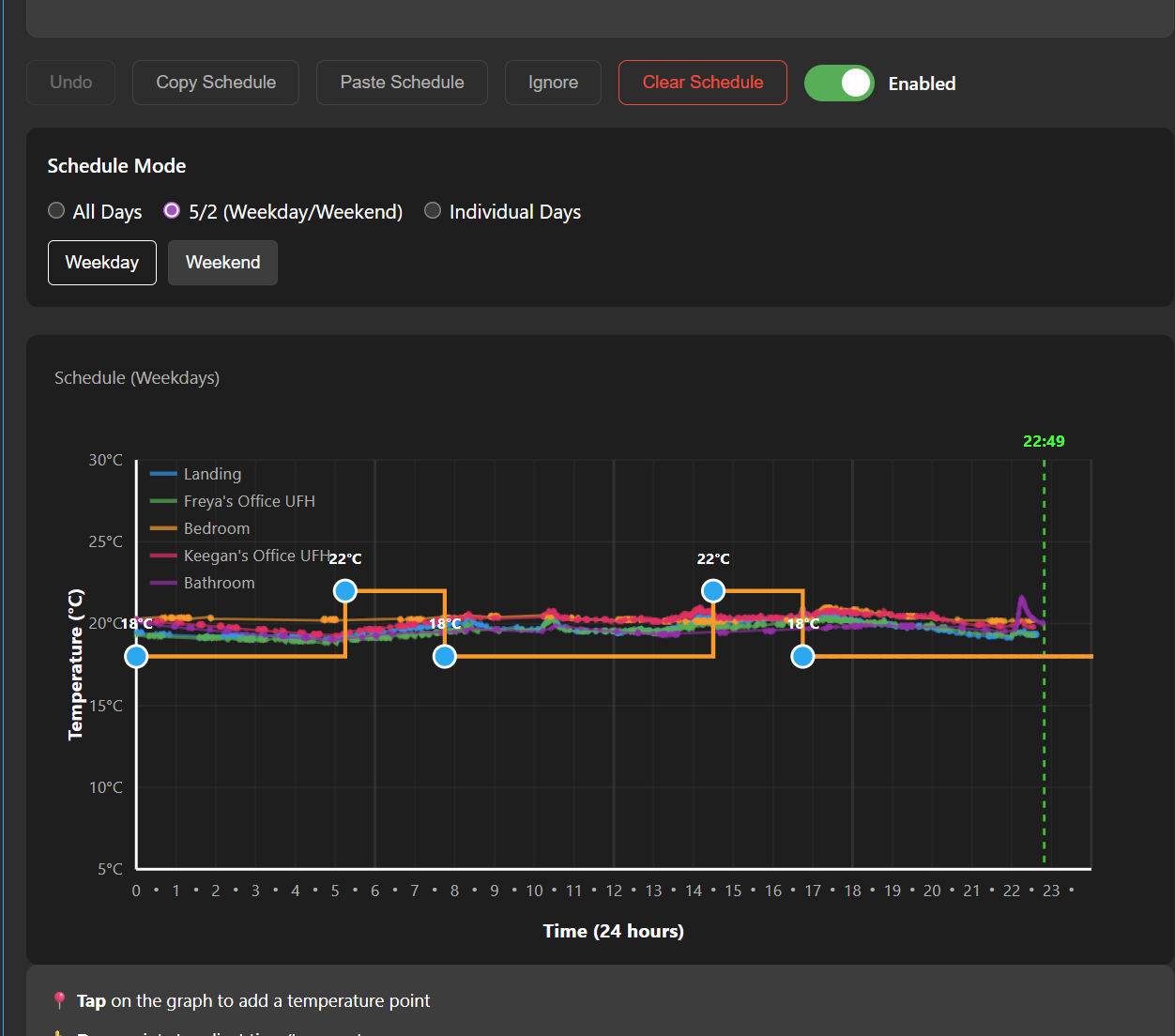

Installed fine now and I started trying it out but ran into a few issues:

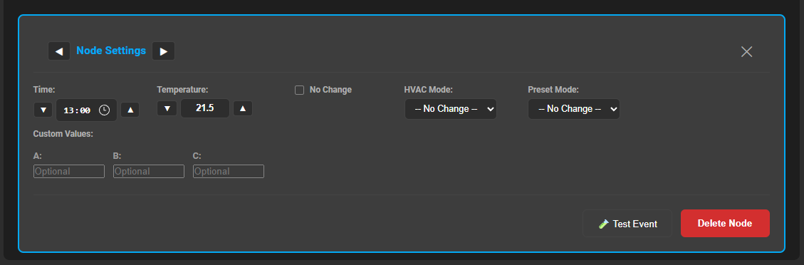

Some of the selections are not very ‘sticky’, e.g.
  1. If I set the HVAC Mode of a node to ‘Heat’, then select another node and come back to the 1st node, it shows HVAC Mode ‘Off’ again.
  2. If I switch off ‘Enabled’ for a climate entity, go to another climate entity and come back to the 1st one it’s enabled again. This means that the Climate Scheduler will take over my climate control no matter what I say, unless I ‘Ignore’ the climate entity - and then it needs a screen refresh to move it to the bottom ‘Ignored’ section again.
Other observances:

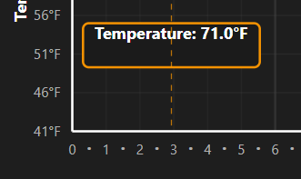

  1. I need to double-tap on the graph to add a new setpoint (instead of single-tapping as the instructions seem to indicate)
  2. Before I add a new node, the orange box - see below - should show the time and the temperature I’m about to select, not the actual temperature at that point in time.
Thanks for the feedback, adding the historic data has confused things more than a little for sure, I’ve been changing things quicker than I’ve been updating the instructions too for sure…
I’ll have a look at these as they’ve been on my list to fix too, with someone else hitting these issues it’s easier to convince myself it’s worth fixing!
I’ve added a settings pane where you can switch modes for the tooltips, between historic values and what’s currently under the mouse pointer. If in historic mode you should still see pointer values while dragging.
I’ve also hopefully fixed a bunch of issues with HVAC and similar settings, let me know if you have any issues with those.

Also added a big quality of life update in the shape of copy/paste for the schedules. You should be able to copy an existing one to newly created days to speed things up.
