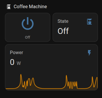

Coffee Machine State Sync
Keeps a input state and a boolean state in sync with a coffee machine to allow you to remotely or in person be powering the machine off and on without reality and HA getting out of sync.
Requires a helper for the state and a helper for the power switch.

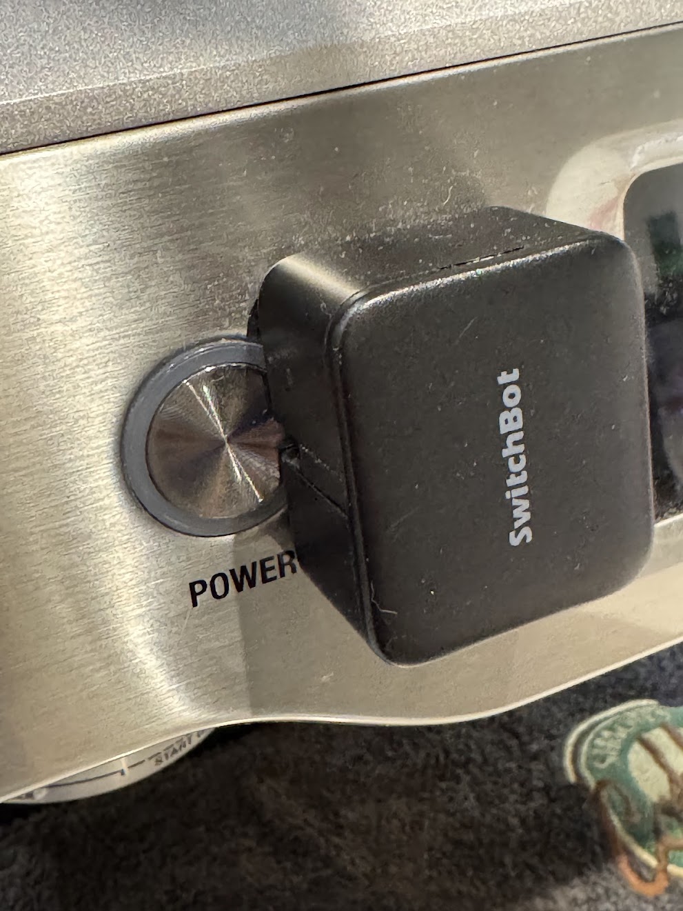

I am driving this personally with a Switchbot and a Moes current sensing switched outlet.
