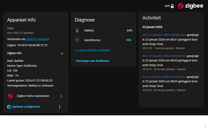

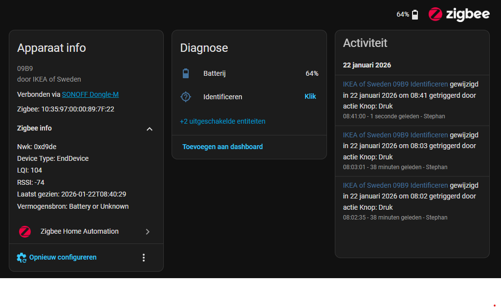

If I go to the device page and click the buttons nothing really shows up. No event, no entity, nothing.
Identify option does make it blink its LED in the middle…

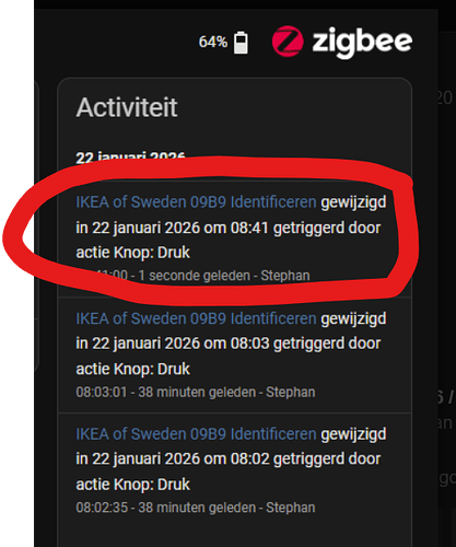

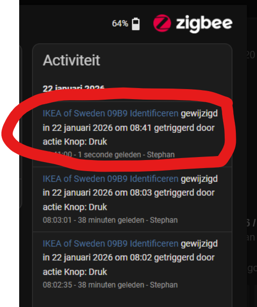

I’m not good at Dutch, but doesn’t this say button pressed?
Yes, it does. But it is the identify button from HA to the device itself.

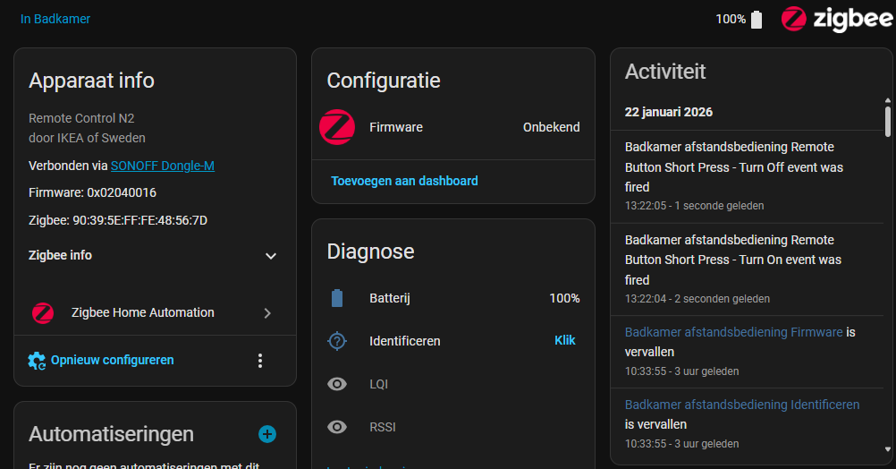

Hmm, I guess you are partially correct indeed. Another Zigbee based remote also doesn’t show the button status. But when I press the button it does show two events, Turn on and Turn Off:
They are missing with the new remote
