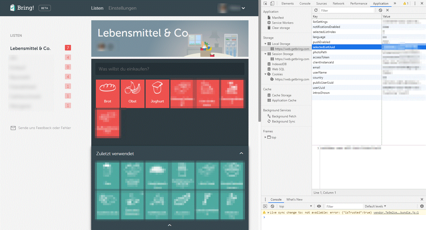

I got the List-ID from the developer tools of Chrome. For this a picture:
If I set this one here I get a value back:
https://api.getbring.com/rest/bringlists/{LIST_ID}/details
