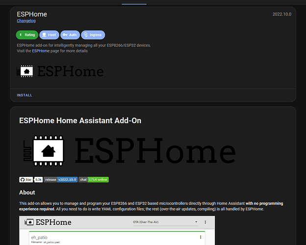

OK, I think I see the problem now. Was something completely changed around v2022.3.1? I have kept all my add-ons (incl. ESPHome) up to date, but I can see when I try to look at changelog that the add-on does not exist:
Following the link in the discord channel, I get a different add-on with a different icon etc.
Old:
Screenshot 2022-10-12 at 22.53.25
New:
Screenshot 2022-10-12 at 22.53.30
So maybe the repo was changed without notice (without notice in the HA UI at least)? In any case, it looks like it’s working now. Thanks!

If the link doesn’t work, you should be able to upgrade by going to Home Assistant “Settings” → “add-ons” → “Add-on store” and scroll down until you find ESPHome:
Install the first one. The n go back to your “add-ons” overview and see if you have two called ESPHome. If you do, delete the one that doesn’t look like the screenshot above.

Thanks. I just did the latter (Settings - Add ons etc) as per you now edited post, and deleted the old version. I do tend to read the home assistant release notes but didn’t notice this “breaking change” anywhere. Have I got to do this every time there is an update to ESPHome?
Good to hear! Yeah, I also read the HA release, and missed the ESPhome one.
No, this should be it. It is now “officially” in the main Home Assistant Add-On store (which it wasn’t before) so there should be no more surprises like this waiting.
