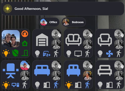

I’ve also done a quick mock-up of how room presence can be nicely implemented in a lovelace frontend view.
In this example, both Person 1 and Person 2 are home (along with their car). Person 1 is in bed, their bed presence on the right side of the bed is indicated. They have also triggered motion in the bedroom. Person 2 is in the Living Room with the TV on. There is no motion detected in that room but Person 2 will remain set in the living room since her presence is currently being set by BLE room presence detection. Both the bathroom and the kitchen are empty and the shower is not running.
