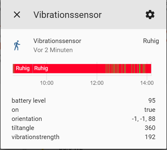

I cant get it working
binary sensor is up and running in HA via deconz. Motion is detected…
My test automation is
  • id:
    alias: Vibration
    • event_data:
      event: 1007
      event_type: deconz_event

Log:
019-04-30 13:56:11 DEBUG (MainThread) [pydeconz.deconzdevice] Vibrationssensor created as
{’_async_callbacks’: [],
‘_battery’: 95,
‘_deconz_id’: ‘/sensors/4’,
‘_ep’: 1,
‘_etag’: ‘1a6a019a050ce43652fd4c01b94a8545’,
‘_lowbattery’: None,
‘_manufacturername’: ‘LUMI’,
‘_modelid’: ‘lumi.vibration.aq1’,
‘_name’: ‘Vibrationssensor’,
‘_on’: True,
‘_orientation’: [0, -1, 89],
‘_reachable’: True,
‘_sensitivity’: None,
‘_sensitivitymax’: 21,
‘_sensor_class’: None,
‘_sensor_icon’: None,
‘_sensor_unit’: None,
‘_swversion’: ‘20180130’,
‘_tampered’: None,
‘_tiltangle’: 5,
‘_type’: ‘ZHAVibration’,
‘_uniqueid’: ‘00:15:8d:00:02:b7:69:bf-01-0101’,
‘_vibration’: False,
‘_vibrationstrength’: 80}
Does anyone have an idea ? I also tried the name vibrationssensor

hmmm i have a binary sensor…
Iam now using it based on the state… there are no deconz event for my vibration sensor… it works like charm with e.g smart switched
