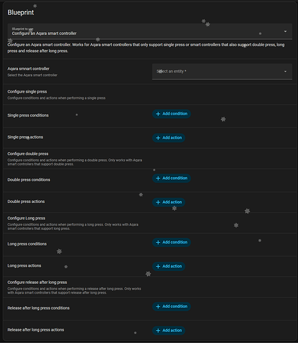

Configure Aqara smart controllers in an automation
This blueprint automation enables you to configure an automation with an Aqara smart controller. Actions can be configured for single press, double press, long press and long release.
The blueprint does all the logic and conditions. Based on device type (if it also supports double/long press) it will automatically select between initial_press or multi_press_1.
You only need to select the entity, any additional conditions (optional) and actions for each type of press. You only need to fill the conditions and actions of the press types you want to configure.
Blueprint has been tested with:
  • Wireless Mini Switch T1 (single press, double press long press, release after long press)
  • Wireless Remote Switch H1 (single press, double press long press, release after long press)
  • Aqara Light Switch H2 EU (single press)
You can find my blueprint here:
blueprint:
  name: Configure an Aqara smart controller
  description: Configure an Aqara smart controller. Works for Aqara smart controllers that only support single press or smart controllers that also support double press, long press and release after long press.

trigger:
  - platform: state
    entity_id: !input entity
    not_from:
      - unavailable
    not_to:
      - unavailable
      - unknown
action:
  - variables:
      command: "{{ trigger.to_state.attributes.event_type }}"
  - choose:
      # SINGLE PRESS
      - conditions:
          - condition: template
            value_template: >
              {{ trigger.to_state.attributes.event_type in ['initial_press', 'multi_press_1'] }}
          - condition: and
            conditions: !input single_conditions
        sequence: !input press_single
      # DOUBLE PRESS
      - conditions:
            value_template: "{{ command == 'multi_press_2' }}"
          - condition: and
            conditions: !input double_conditions
        sequence: !input press_double
      # LONG PRESS
      - conditions:
            value_template: "{{ command == 'long_press' }}"
          - condition: and
            conditions: !input long_conditions
        sequence: !input long_press
      # LONG RELEASE
      - conditions:
            value_template: "{{ command == 'long_release' }}"
          - condition: and
            conditions: !input release_conditions
        sequence: !input long_release
mode: single
