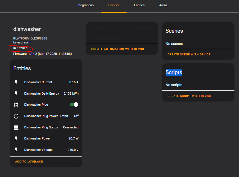

After months of ignoring areas, I finally had some free time and decided to play around with it. I created two area’s even restarted HA, and after an hour or so, still cannot figure out how to add an entity or an integration to an area. Does this require yaml? Not sure I have a use for it, but wanted to see what it could do. I have zwave, zigbee, homekit, echos, ecobee, hue and have not seen anywhere for any of these as to where I would add the area. Any help is appreciated
No need for YAML. If you add a device via the Configuration --> Integrations menu you can assign the device to an area.
I’m not seeing how to add a device to an area. Do I have to remove every device and add again to select an area during adding??
When you’re displaying an entity’s Device Info page, look in the upper right corner. You should see a gear icon. Click it and you’ll be able to change the entity’s Area.
