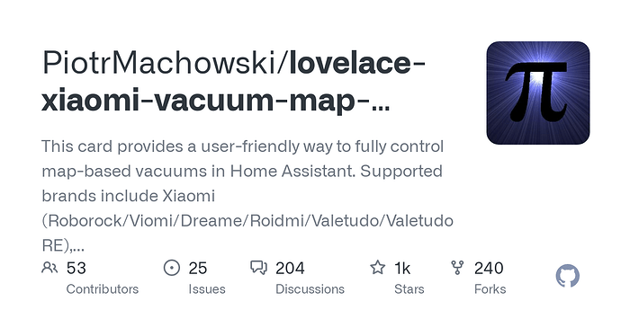

But i have a map, predefined rooms, zone cleaning from HA, but you don“t see the robot and it is not live. Map is based on floor plan drawing, and calibrated by using coordinates and XY pixels. Look here:
I am using that card, and in addition a card from here:
Thanks, I will do that.
I tried a number of options to get the right coordinates, The Flolevac app returned a jibberish map that was no use. Finally I just measured my room and calculated coordinates based on 1 point is 1 mm and the center is [25600, 25600]. What did not help was that the lovelace-xiaomi-vacuum-map-card remembered the old data, even after clearing the cache and rebooting my computer. If I updated the map.png I kept getting the first one I made, so I ended up with map6.png.

Anyways, here’s what I did to get the coordinates, with a screenshot of the Xiami Home map.
From Developer Tools, Services, choose service vacuum.send_command and give these parameters:
  entity_id: vacuum.stoffel
  command: app_goto_target
  params: [24600, 24600]
This helps with finding the right coordinates on the map.
I ended up with this in my configuration:
- calibration_points:
      x: 20900
      y: 19500
    map:
      x: 37
      y: 37
  - vacuum:
      x: 26300
      y: 19500
    map:
      x: 37
      y: 1275
  - vacuum:
      x: 26300
      y: 29500
    map:
      x: 2361
      y: 1275
One funny thing I noticed is that when the Roborock encounters a mirror (or a shiny vase on the floor) it thinks that there is something behind the mirror. Next time I will check if it slows down there or just crashes hard in the mirror. :slight_smile:
I used my original house floorplan drawing, and used paint.net with layers to create the map.
Then used goto to three points to get the calibration coordinates.
