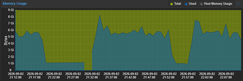

@serville are there RAM spikes showing in Proxmox?
Oh yeah, should have mentioned that, virtualised, running HAOS (supervisor and core).
It’s kind of spiky :smiley:

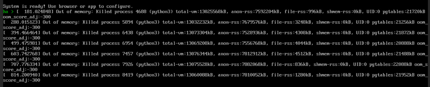

looks like i’m out of RAM:
considering none of my addons are running, this shouldn’t be the case
