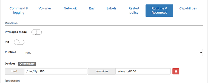

  2. Configure the container with the following:
  • Publish all exposed network ports to random host ports (Or else, if you want to specify it, the image uses port 3333)
  • Command: '/bin/sh' '-c' '/usr/sbin/ser2net -d -u'
  • Entrypoint: /usr/bin/entry.sh
  • Bind Volumes: /etc/ser2net.conf with host: /mnt/data/supervisor/homeassistant/ser2net/ser2net.conf
  • Add device for host and container: /dev/ttyUSB0 (Or whatever maps to that usb-to-serial device)

here are some screenshots of my settings for this container in portainer. This should help you set it up.
Thank you for the screenshots. I managed to create the container as per instructions but once it starts it stops. I check the logs and get the following:
