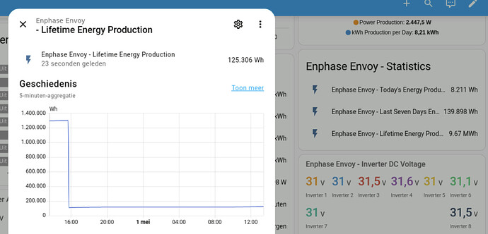

Correct Envoy lifetime production energy
With your the inverters in round 2, the next question is the step down in 2025. Is it something I can expect as well happening somewhere later in round one, or is it just another firmware version phenomena?
Looking at the step down value, between 14 and 15 MWh looking at the screenshot, it also might be related to the magic value, 14 / 12 = 1.16.
Calculating backwards, an overflow supposedly happens when an 8 byte memory location is involved. (FFFFFFFF = 4294967295) Converting that from joules to Wh (/3600) we get 1,193MWh (and small change). That number for your 12 panels totals to: 14.3 MWh. Awfully close to what seems to be the step size in your screenshot. Is it?
Wild guessing, if at that time your Envoy got updated to the current firmware (or a prior firmware with same code change) and all your inverters where beyond the 1,19 MWh mark, the overflow would hit for all right away and drop the lifetime with 12 times overflow.

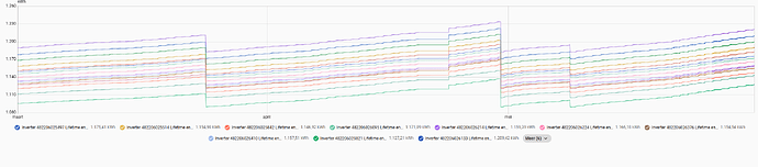

Basically the same here, with one other glitch though. When you take a look at my screenshot some replies back, all inverter lifetime values stepped down with a small value (and envoy lifetime stepped up). That step change is now the offset between summed inverter lifetime and the Enphase portal.

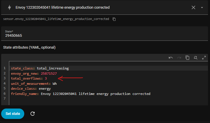

I have had 10 overflows in the past days. is there a way to manually add these to the corrected sensor so that the total value is correct again?
Assuming you refer to the blueprint:
Yes, go to settings / developers tools /states and find your corrected entity
Then change total_overflows to the actual overflows and click set state. Next value change should add the correct number of overflows. If it doesn't change to the correct number, you may have been collding with an actual value update, then try again.

The jumps in the Envoy lifetime value happen when an individual inverter passes 1.19 MWh in its lifetime value. In my case it took like 3 years for the first one to reach that lifetime value.You can check those values in the series overview in the Enphase portal to see if any passed that value yet.

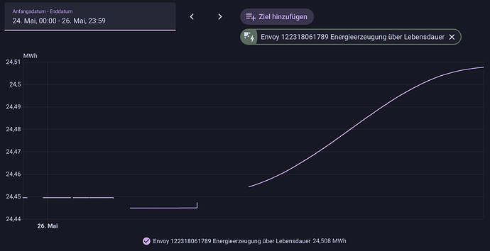

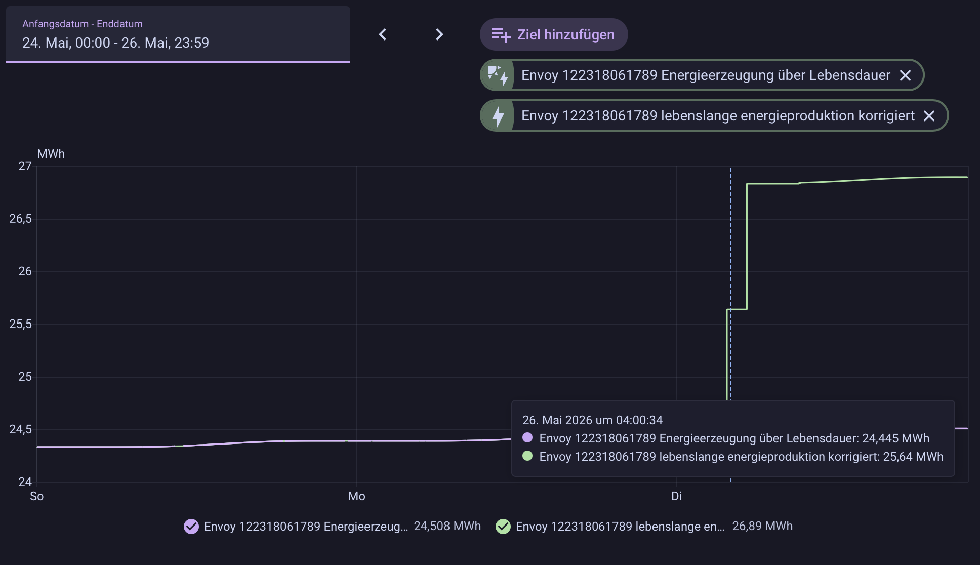

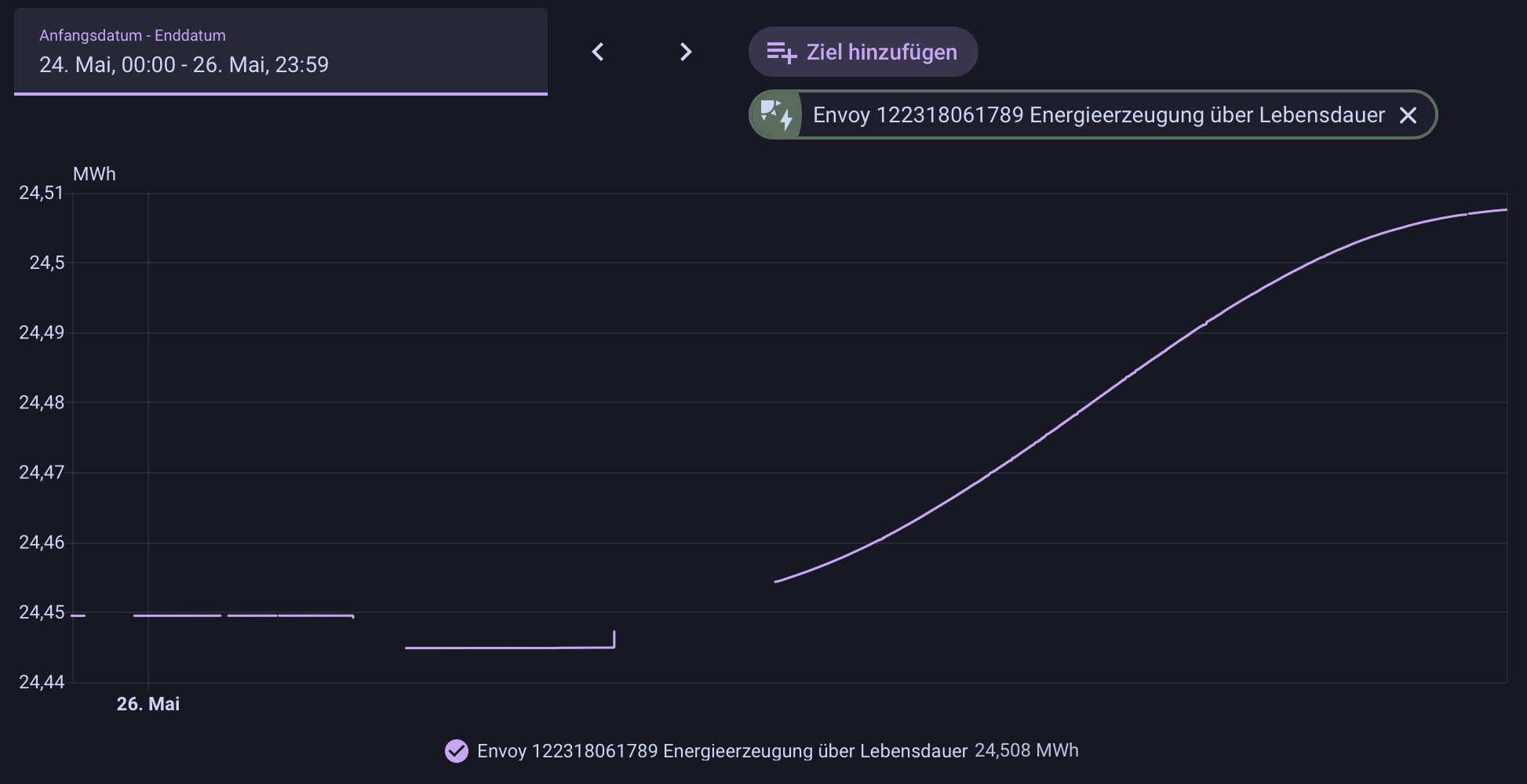

Okay, something did happen and the correct lifetime sensor based on the blueprint says 2 overflows. But when looking at the two sensors side by side (green is the corrected), I don't really understand what happened here. I thought, the corrected sensor would show the right value (e.g. goes up steady) and the original sensor would go down by 1.19MWh for each overflow. But instead, the corrected sensor goes up 1.19MWh? The value in the Enphase App is still 24.5MWh, not 26.83MWh as the corrected sensor is now stating.
Did I setup something wrong? This is my template setup:

Additionally, my Envoy was not available for API calls last night (just before these two jumps). Could it be, that a new firmware version remedies the overflows internally and calculates some stuff so the Envoy is not responding well on API calls? My firmware is 8.3.5289.
Yes, a firmware upgrade may have reset something.

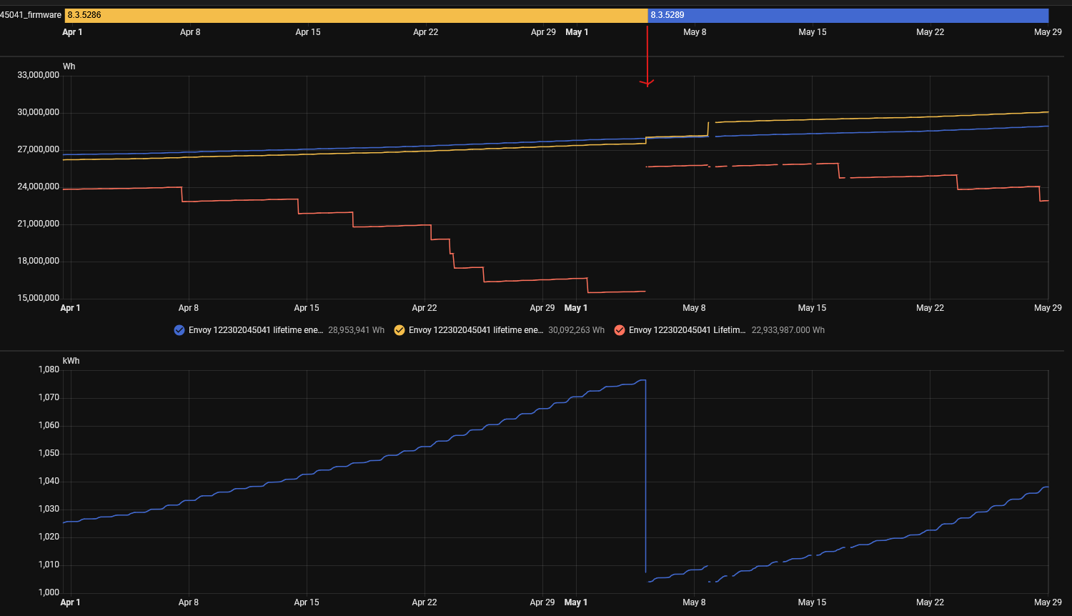

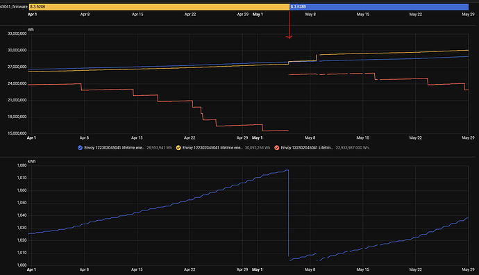

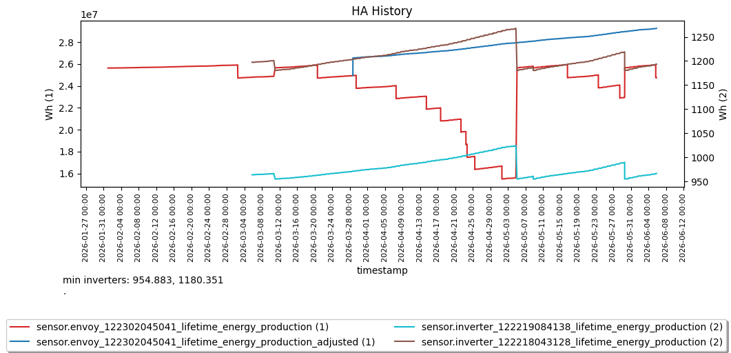

I had one time that all my inverter lifetime values stepped down and the envoy lifetime step up. See a previous reply. That happened before I had a correction active.
I then implemented the correction blueprint. That didn't calculate the correct value as the change caused by the inverter lifetime changes wasn't the 1.19MWh. I added another adjusted calculation that doesn't use the step size of 1.19MWh but actual detected changes up and down and started testing it as no-one had reported these inverter lifetime changes at that time.
In below screenshot, top-half, the orange line is the corrected value and the blue line is the adjusted value. Both methods handle the lifetime change of 1.19MWh equally well. BUt step-up in lifetime value is only handled correctly by the adjusted method.
Bottom half of the screen shot is one of the inverter lifetime values, all 24 inverters look the same.
Then my Envoy got updated from 8.3.5286 to 8.3.5289, and again inverter lifetime values dropped and Envoy lifetime values stepped up. But not with the 1.19MWh value. And shortly after the update another drop in inverter lifetime and increase (not being 1.19MWh) in Envoy lifetime. Again the adjusted method calculates incorrect, the corrected method under test handled it well again.
So right after the firmware update, the screenshot shows 2 step changes in the corrected value. This resembles very much what you are seeing. If you have individual inverter lifetime energy production values, check if these stepped down at that time. If so you are seeing same phenomena as I do and I probably best publish the correct blueprint as well.

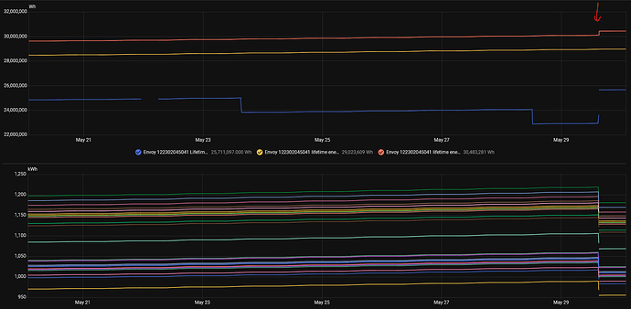

To continue the story, yesterday the lifetime production value of all of my inverters stepped-down (again) and the Envoy lifetime value stepped up.
Top half, blue: Envoy lifetime, red: Envoy lifetime corrected using original blueprint, orange: Envoy lifetime adjusted using modified blueprint.
Bottom half the individual inverter lifetime production.
All individual inverter lifetime values are again below the 1.19MWh value. Envoy lifetime value matches the sum of the individual inverter values.
This is the 3th time this happened, no firmware change and once with a firmware change. The Envoy lifetime value is too low compared to Enphase portal, the corrected value to high and the adjusted value (still) matches the Envoy portal lifetime value.

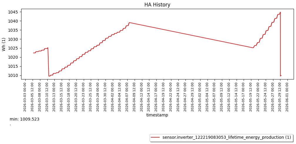

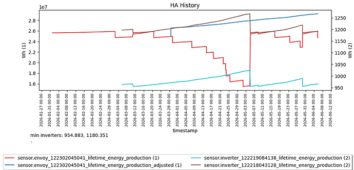

Hi @catsmanac
I did look into my history of the livetime values of the inverters, and i my situation, all fall-backs seem to fall back to the same values.
After every fall-back the inverters have the same lower values as at the previous fall-back:
(ignore the horizontal parts in the end of April, at that time my RPi4 died and I replaced it).
Can you confirm this fall-back to these same values?
Currently I can't inspect all my data (the middle section of below plot), but data for 2 cases confirm it 's the case

Fall-back is to the same value each time for an individual, different values for each inverter.
Later this week I should be able to inspect more data.
I don't have the lifetime energy production values for all inverters activated. But what I still don't get. The original lifetime value is still the correct value compared to the Enphase app. The corrected lifetime value (because of 2 overflows) is 2,386092 MWh too high. It seems, that I don't need the blueprint?
If your lifetime energy is correct, the the blueprint is not needed. The blueprint will add a correction step up when it detects a downward value change in the lifetime value. Your original picture shows such value changes. If the value change you experienced was an intended correction by the firmware and matches the enphase portal data then some other magic occurred and it seems you are fine now.
Verified all my data and in all cases the fallback is to the same value. Below screenshot with higest and lowest inverter from the series.
So far it seems using step sizes rather then step counts in the blueprint is still working correctly for step size not matching the magic number (which I had). For now, my adjusted blueprint is here: adjust_envoy_livetime_production_energy.yaml · GitHub.

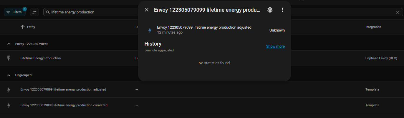

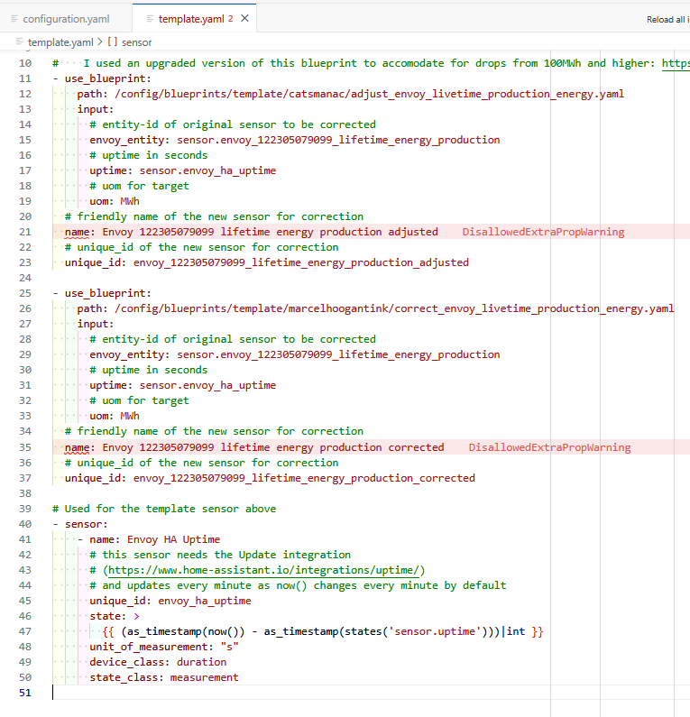

I can't seem to get the blueprint working. I tried the Corrected and the Adjust one. Both templates stay on a "unknown" value:
In my template.yaml the "name" does give an error, which refers to the syntax being incorrect. But it is how I copied it and the same as is the example in the "Using blueprints" section on home-assistant.io. So I don't think that is the issue.

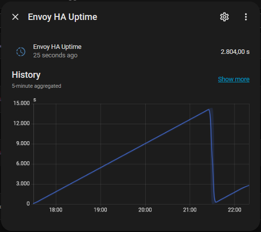

I imported the blueprints and the uptime integration is working.
I think I tried everything. What am I doing wrong? I hope anyone can steer me in the right direction.
