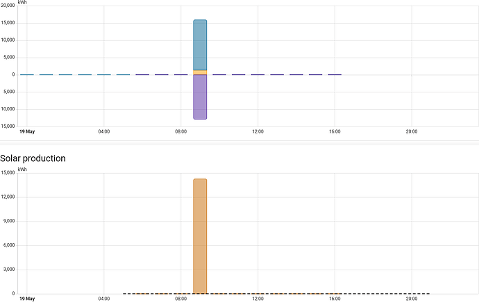

For me this is always triggered by restarting Homeassistant. Then the statistics start counting again from zero, hence these high values.

Hi all, this issue started today, I also have no outliers on statistics. but battery shows crazy consumes

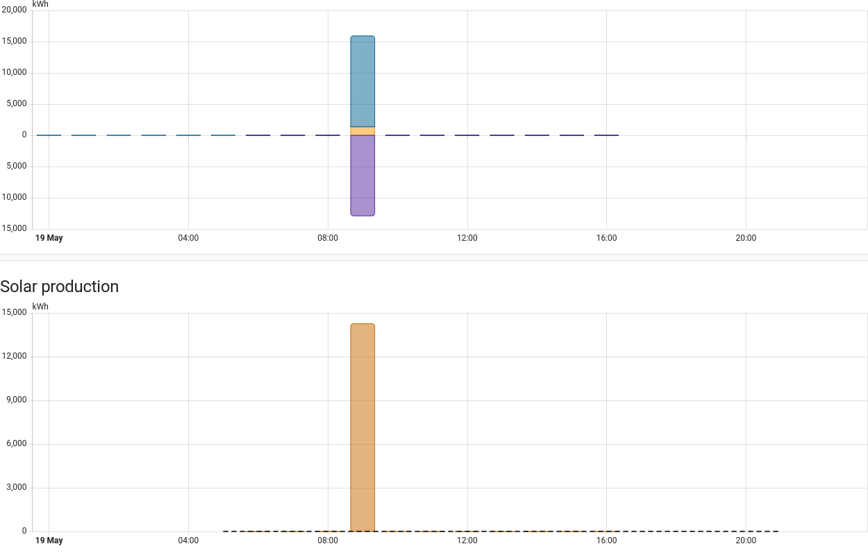

I have the same issue, probably after rebooting my Raspberry Pi where HA is running on.
