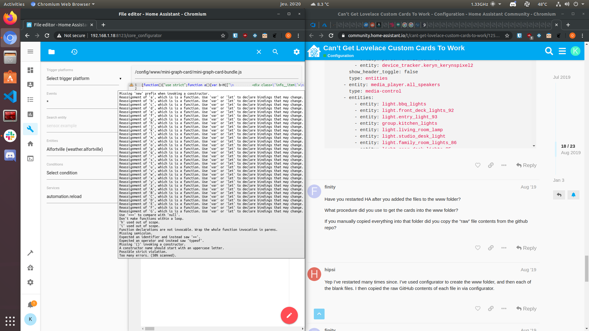

kaysan13
(Kaysan13)
April 2, 2020, 6:33pm
7

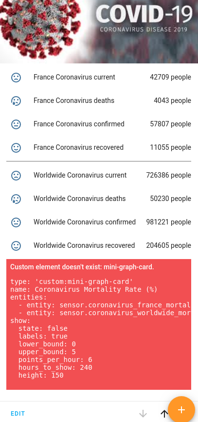

I have the same problem, i have
/config/www/mini-graph-card/mini-graph-card-bundle.js
with this error
And when I try use the mini-graph
resources:
- url: /community_plugin/mini-graph-card/mini-graph-card-bundle.js?v=0.9.3
type: module
type: entities
show_header_toggle: false
header:
type: picture
image: >-
https://encrypted-tbn0.gstatic.com/images?q=tbn%3AANd9GcS7ovkoWSZdub9adLaiuFEdXYUzjZ6bSSNXPA6vT3z3gmCccuMr
entities:
- entity: sensor.france_coronavirus_current
- entity: sensor.france_coronavirus_deaths
- entity: sensor.france_coronavirus_confirmed
- entity: sensor.france_coronavirus_recovered
- type: divider
- entity: sensor.worldwide_coronavirus_current
- entity: sensor.worldwide_coronavirus_deaths
- entity: sensor.worldwide_coronavirus_confirmed
- entity: sensor.worldwide_coronavirus_recovered
- type: 'custom:mini-graph-card'
name: Coronavirus Mortality Rate (%)
entities:
- entity: sensor.coronavirus_france_mortality
- entity: sensor.coronavirus_worldwide_mortality
show:
state: false
labels: true
lower_bound: 0
upper_bound: 5
points_per_hour: 6
hours_to_show: 240
height: 150
But
Expected a value of type undefined for resources but received [{"url":"/community_plugin/mini-graph-card/mini-graph-card-bundle.js?v=0.9.3","type":"module"}]
I have the same problem when i try
Expected a value of type `undefined` for `resources` but received `[{"url":"/local/mini-graph-card/mini-graph-card-bundle.js?v=0.9.3","type":"module"}]`
Does anyone have any ideas
Thanks
