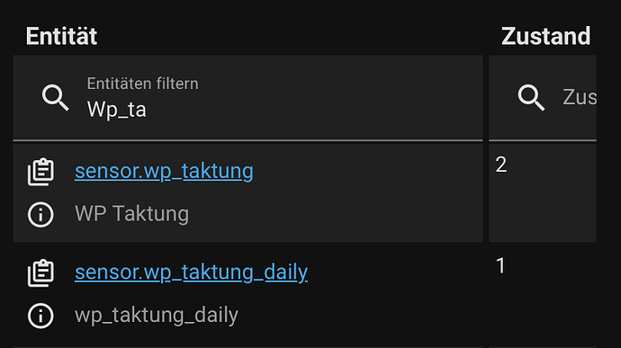

Ah the history stats seems to work. Example today is 1 (right), but the daily utility is 0 (wrong)

@vingerha i don’t understand it. The most time it works finde, but sometime the count is wrong:
My sensor looks like:
platform: history_stats
entity_id: sensor.wp_status_value
state: "0.0"
type: count
start: "{{ now().replace(hour=0, minute=0) }}"
end: "{{ now().replace(hour=23, minute=59) }}"
Here is the state and the logbook. The value and count should be one, but is two. I have no idea why?

What is the value of the sensor shortly befor emidnight? If that is not 0.0 then I guess it would start with 0, if it is 0.0 then it would start with 1…but to be 100% honest, the details on a restart of a history stats sensor is not fully transparent to me.
You could try it out with a different start (during daytime) and manually update the sensor to see what it does
what I (me) would expect
23:59 state: 0.0
00:00 wp taktung: 1
why: it restarts, finds value 0.0 so 1
with similar thoughts:
23:59 state: 0.1 (not 0.0)
00:00 wp taktung: 0
However, it could also be that the reset at midnight means to start from 0 and only after it re-hits 0.0. then it starts counting
@Mariusthvdb
Of course I can do it myself with more effort. I would still be interested why it does not work, what it is intended for.
As it works 99% of the days I would say the value is 0.0 at 23:59.
Can I see the different value in the logbook? Currently it’s pretty easy, the value changes at 11 am o’clock from 0.0 to 0.4
and at 11:30 am o’clock from 0.4 to 0.0.
So it should currently always be 1. Which it usually does, but sometimes it’s two, which makes no sense at all.
