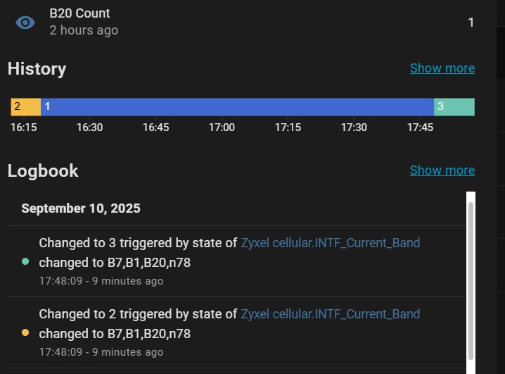

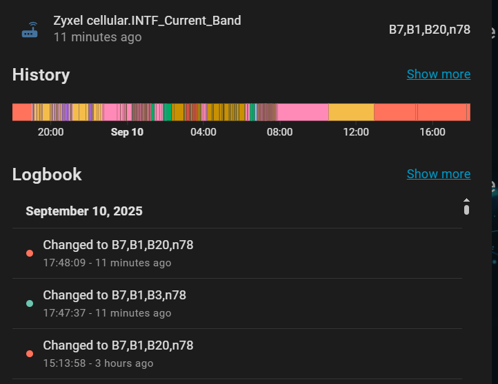

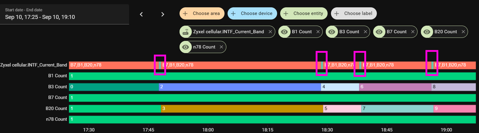

Thank you @tom_l for the hint! It’s almost working, I say almost because when the main sensor state changes the count get incremented by 2:
after state changed like this
how could it be?!
Do you mean this literally? Are attributes supposed to be de facto immutable descriptors of an entity?
another case in which you could see that some template sensor get incremented by 2 and others never get incremented

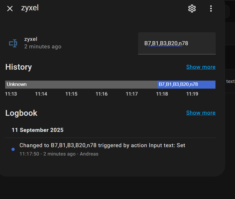

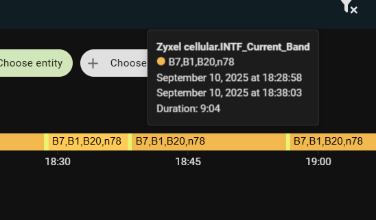

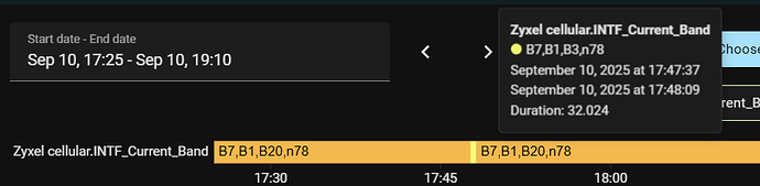

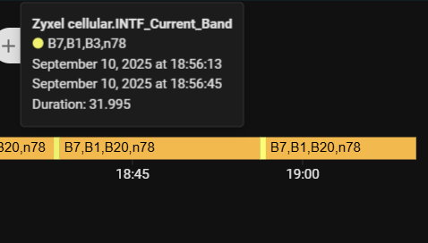

Actually, what is the state of your sensor here (hover your mouse to see):
I can confirm something is wrong.

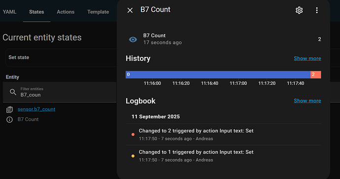

I was so interested in how or why that would happen that I added it to my config with an input text and it does double count.

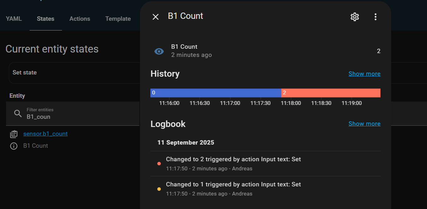

color changed because I did a new query but the data it’s the same:
hope this’ll help

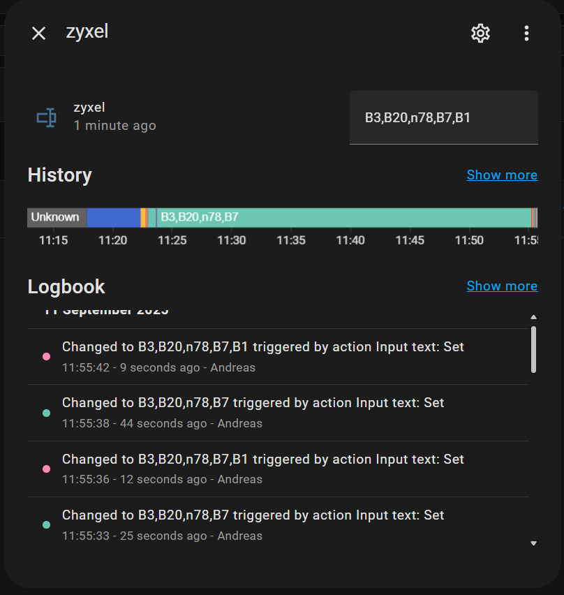

I think I understand why that is.
As far as my limited testing has shown if the state changes from
B3,B20,n78,B7 to B3,B20,n78,B7,B1 then it will not count up any of the values in the first set, only B1.
It seems it has to not be there, then be there for it to count. Which kind of makes sense.
Not sure if that is what you want but I believe that is the case

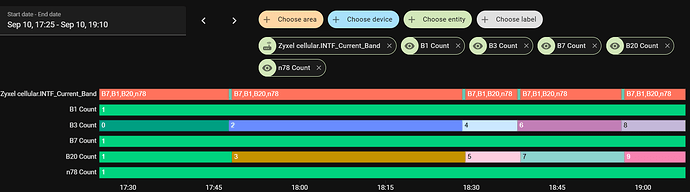

Nope, any change of the sensor state will re-evaluate the templates.
that explains why some sensors didn’t get incremented at every state change.
Since I need to have a “statistical” representation of the most used bands over time, I don’t know how to consider the fact that some band will increment a lot just because they are swapped frequently (not because they are less used) and some will have lower numbers (because they are stable but also because they could be less used).
Still cannot grasp why the double increment at the same state change…

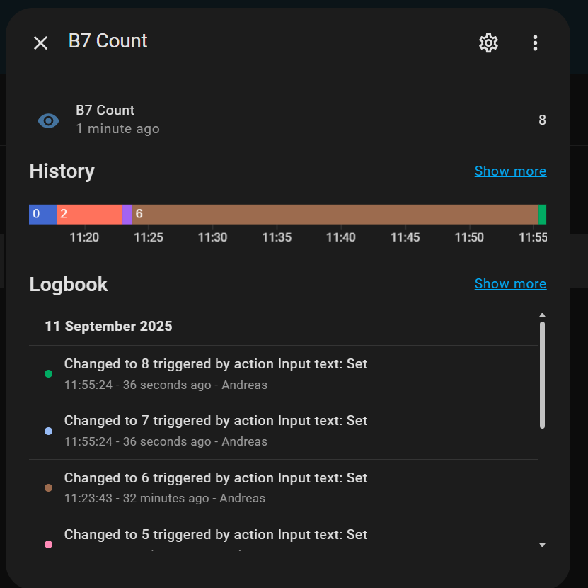

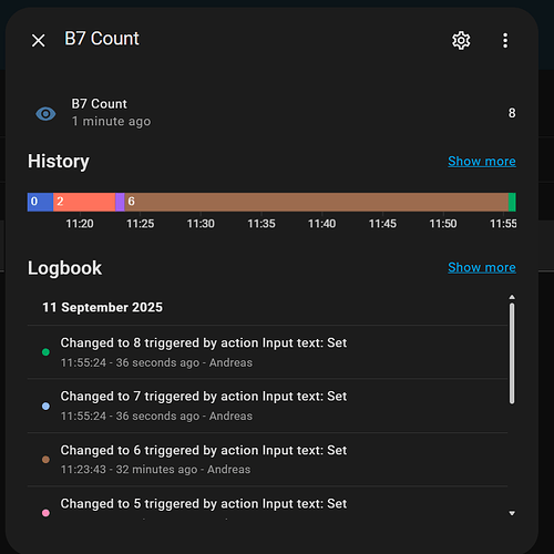

So this here should count B7 four times (or 8) right?
But in reality:
So it only counted it once (or 2 times) the other counts are from 32 minutes ago and is not the same session.
I agree that it should work the way you want it to, but it doesn’t
