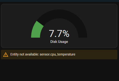

I have this sensor on my HA since I started using this 2+ years ago (installed using the x86_64 on an HP T620 ThinClient). I just updated/updated to these:

…and now I see this on my Dashboard:

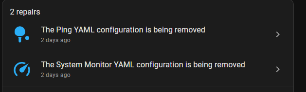

There are also 2 warnings about other things I need to change … what are these and how do I get them working without the YAML?
Also – what is all this madness?
It shows you explicitly the error.
You got a wrong indentation in the 1st line.
That is odd — I do not recall removing the indent. I have put them back … and the errors are gone now. Thank You, but I still cannot get the CPU temp to show now - after the updates. It has worked for 2+ years.
How do I fix this ? Are they saying there is no longer a way to get stats on the hardware, etc.?

I think the first sentence is badly worded. It has not been “removed”. It has been moved to the UI rather than using YAML.
bda2c6c77978c269ca1199b668e40d9bc9a0cf3b
It has been moved to the UI. You can find it in Settings → Devices & Services. Confirm it is there then delete the yaml for system monitor and restart.
There should also be a processor temperature entity in this integration you can enable instead of using the command line.

You should then have a sensor.processor_temperature you can use. If you delete your existing CPU temperature sensor you can edit the entity id of the new sensor (in that last picture) to match the old sensor entity id so you don’t have to change your automations or dashboards.

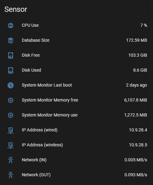

How long before this will be gone? Looks like I still have some entries:
I am guessing that one came from the binary_sensor.yaml which is now commented out in configuration.yaml
:question:Is there some kind of tool to clean (like a defrag on a PC) old stuff? If you install an integration and then remove it - does it “ALL” go away, not parts left over?
