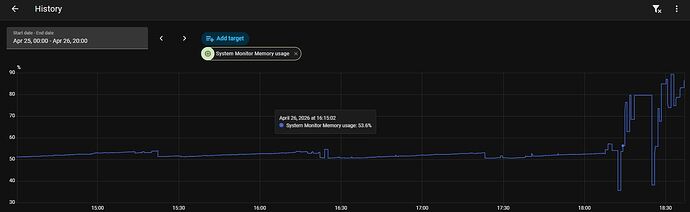

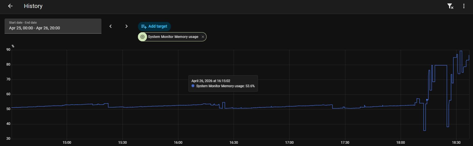

Having exactly the same problem. tried with first release of 2026.4 today again with 2026.4.4 and same problem.
what I notice is that RAM usage gets higher and higher until the crash
I had exactly same issue. Memory usage was going higher and higher until it crashed.
