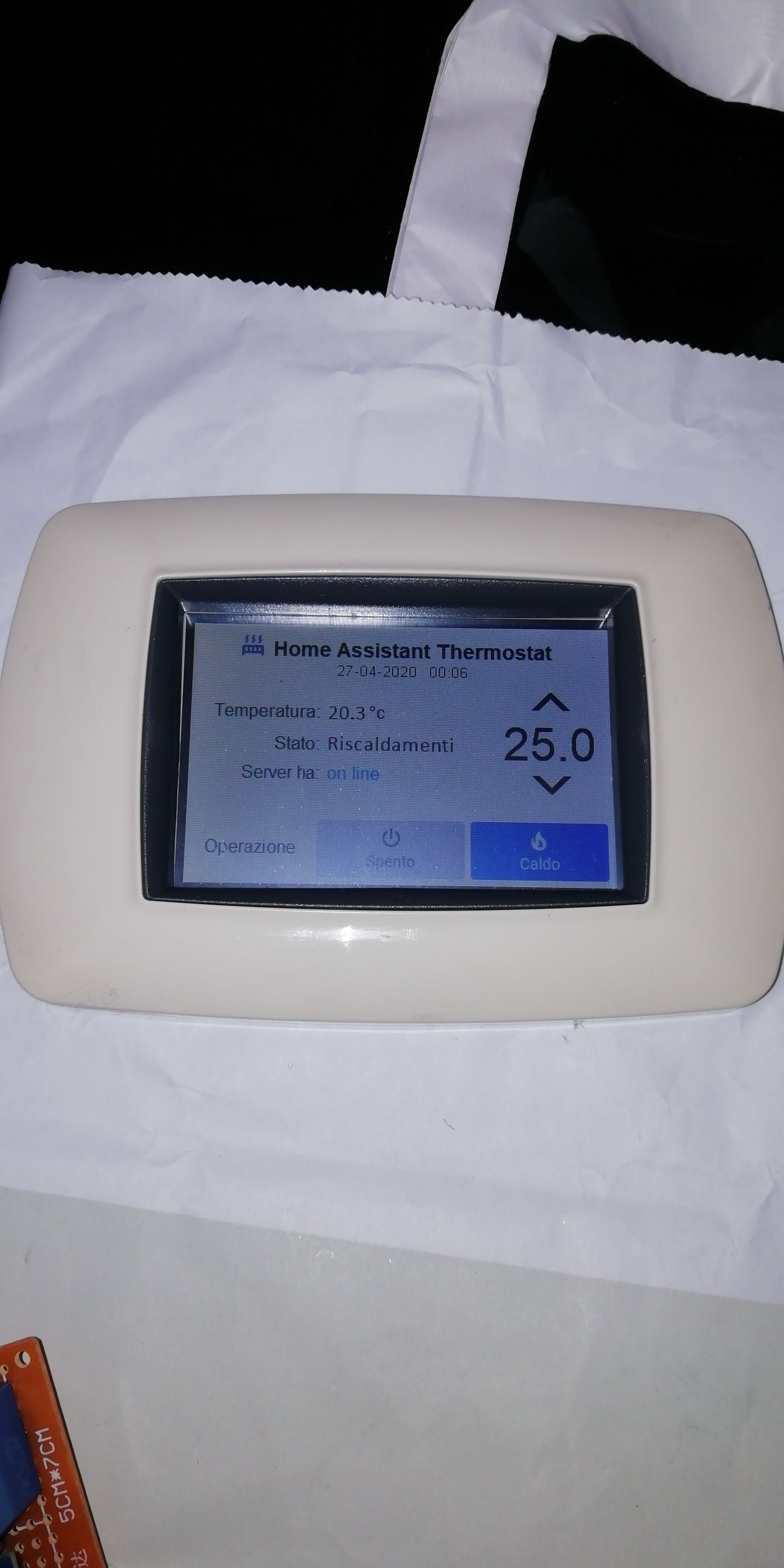

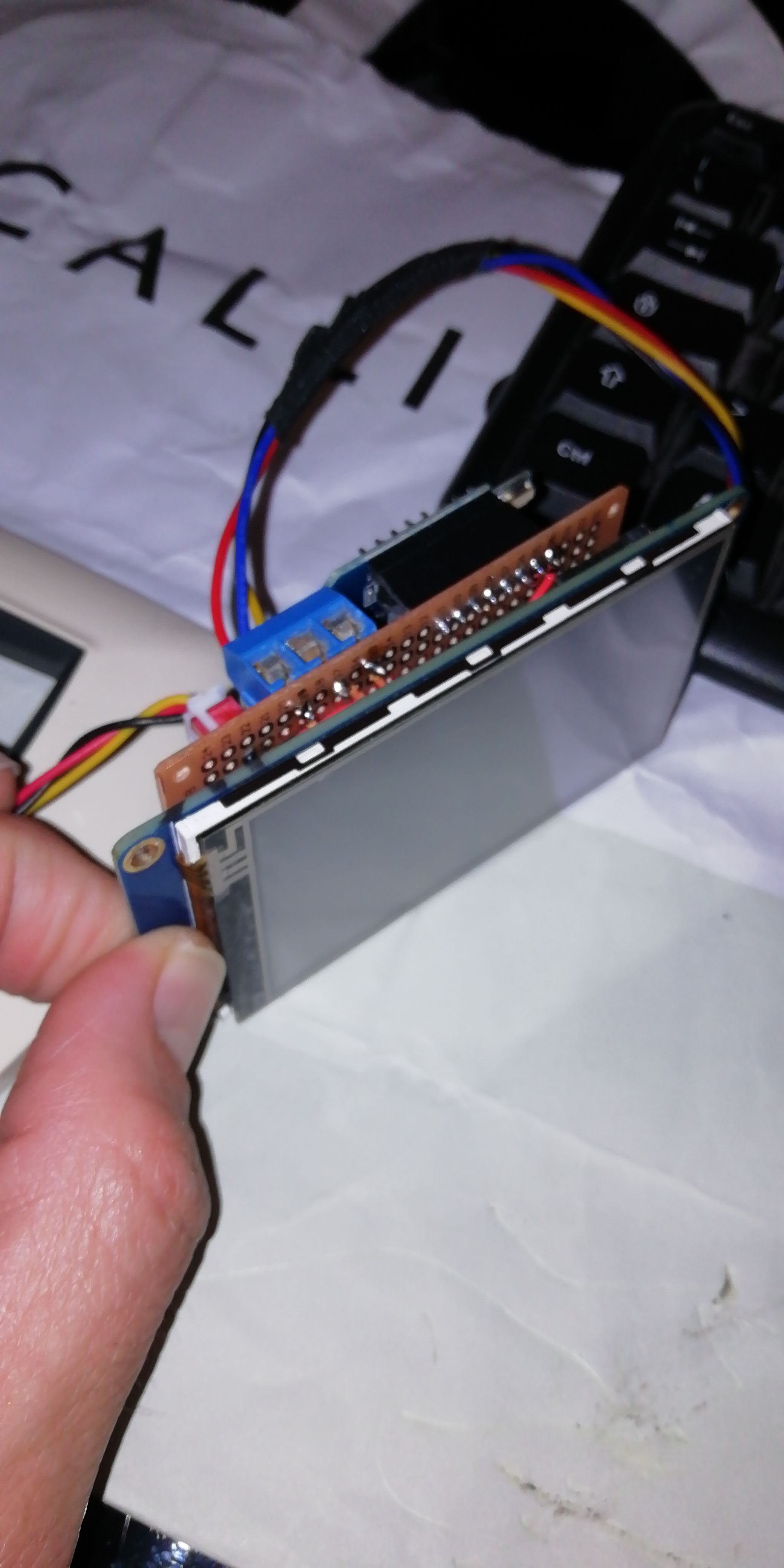

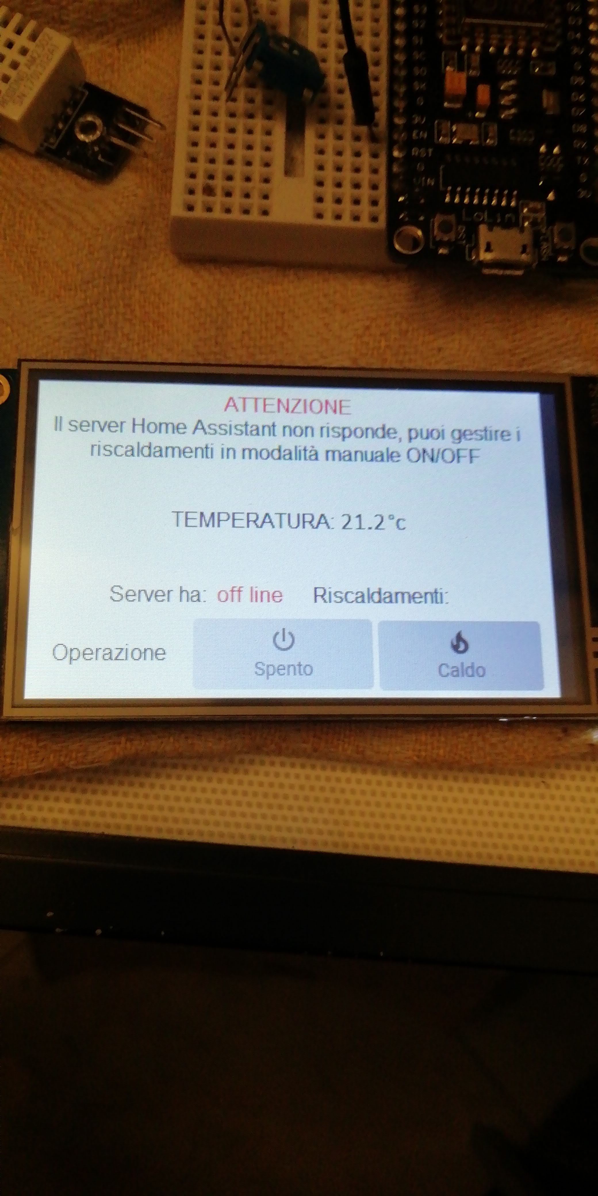

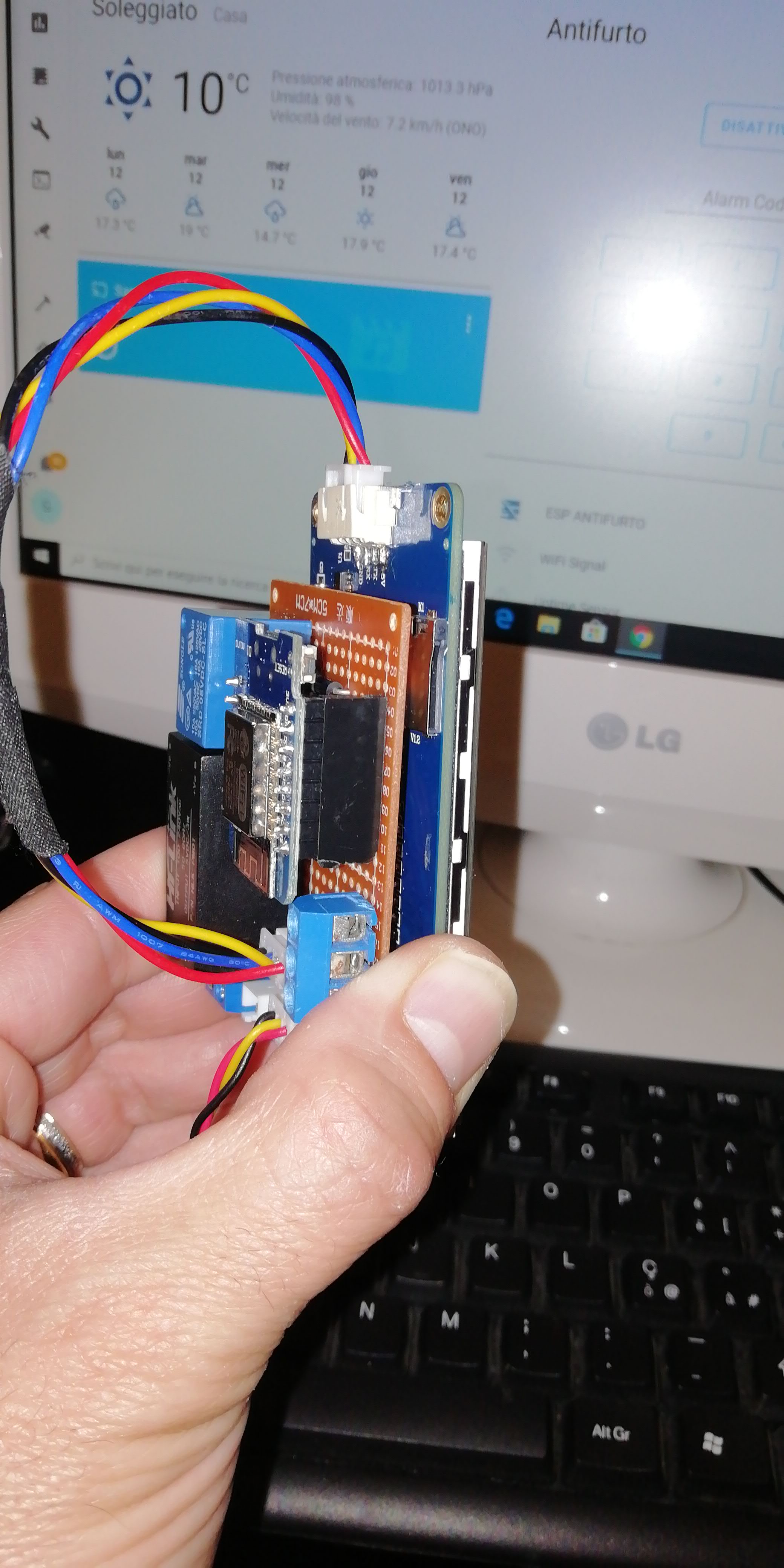

Hi @maxim31. I’m looking for the same thermostat. Independent on HA, but with option to change tempterature, time, etc from HA. Have you idea how to make it?
This is what I did. If there is no connection home assistant, you can activate and deactivate the heaters without logic. If you are away from home and activate the heaters with home assistant logic, if this suddenly stops working, the heaters turn off.

This is the first version, soon I will publish the version with logic also offline.
