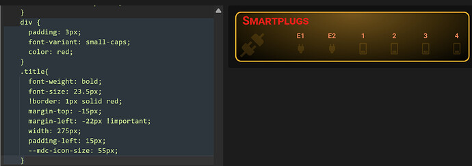

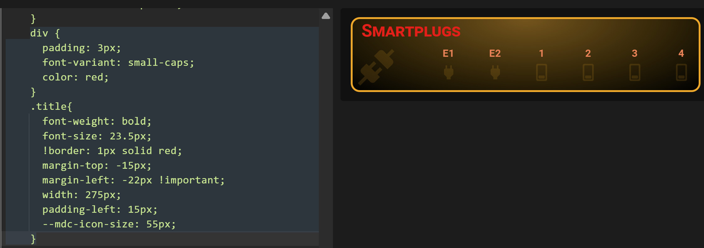

You need card mod for that. Conditions are only for the entities in the card. Not the title
Appreciate your reply! I love this card.
Do you happen to know where I’d put this within card_mod? I thought it would go under my ā€œ.titleā€ section but the ā€œdivā€ section is actually changing the color of the text?
div {
      padding: 3px;
      font-variant: small-caps;
      color: red;
    .title{
      font-weight: bold;
      font-size: 23.5px;
      !border: 1px solid red;
      margin-top: -15px;
      margin-left: -22px !important;
      width: 275px;
      padding-left: 15px;
      --mdc-icon-size: 55px;
You can check this with developer tools in your browser.
Im not near a pc atm so I thought I would tell you how to find out yourself :slight_smile:
I guess I’m not savvy enough to know how to obtain where/what that code should look like or go. Going to the development tools within the browser didn’t really help for me as I always struggled to get webhooks to work correctly. The Title styling when the main entity is on/off is the only missing piece for me. Any assistance is greatly appreciated.
card_mod:
  style: |
    .title {
Should work. Never have been that great with card_mod tbh

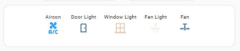

Does anyone have any ideas how to add a glow to the icon? Or other creative solution
I can’t see the light icon when it has turned white.
When I apply my theme, it’s worse because the off colour for the theme is white as well.
Untitled2
Door Light and Fan are off; as a reference.
And to make it even worse, the light starts off as pure white when power is cut and then restored.
I tried out a box shadow but alas the svg canvas is significantly larger than the icon itself and the icon isn’t centered within it.
Untitled3
I’ve noticed that the background size does not match the icon as well. I would maybe try manually setting the color using conditions?
