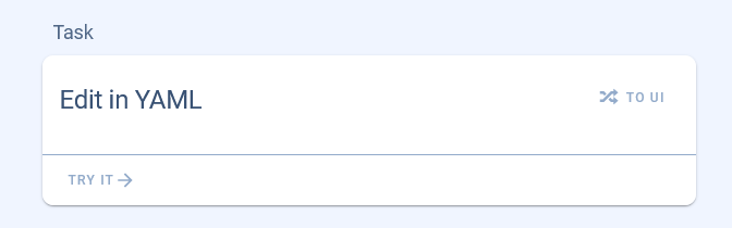

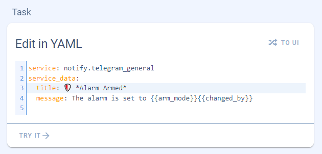

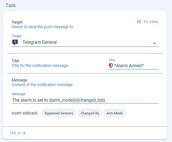

Tried setting this up today. First impressions are that it is very well thought out and easy to configure.
I did find one issue. I can’t edit the message actions when using Firefox, even with enhanced tracking protection off. Chrome is ok though so nothing holding me back.

If you have no suggestions for a solution I can open an issue to track this.
EDIT: I’m also having trouble saving custom actions when I select a script entity type. I can edit this in yaml and get it to save correctly though.

I think the issues you are having is due to some web elements of the HA frontend being not loaded (textfields, YAML editor etc).
I believe the frontend is written such that web elements are only loaded by your browser on pages where they are used (to minimise traffic when you only load a Lovelace view etc).
The bad thing is that for a custom_component it is not possible to interact with the HA frontend and request for these elements to be loaded.
Sadly I have never been able to reproduce what you are seeing. If I could see this myself I could try to fix it.
If you can find a pattern (browser, click path, etc) to see this I would like to hear it, i would prefer if you open a GitHub issue for it for follow-up.
No worries, I’ll open an issue soon. Unfortunate that you have not been able to reproduce it.

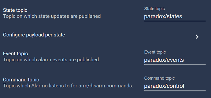

Hello, I not understand how configure paradox with mqtt and alarmo. Not working…all configurations.
