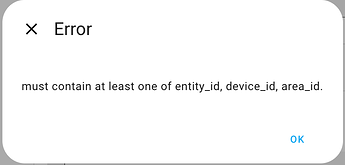

Hi all,
I intend to use Alarmo as a mains switch for all my automations. If alarm panel is set to disarmed, I would like all my automations to be disabled. I am trying the following:
But somehow it doesn’t work. Pushing the TRY IT button brings up this:
Any suggestions? Thanks in advance.
Hi, maybe it might help to show the full YAML code of the task instead of a screenshot.
(How to help us help you - or How to ask a good question)
