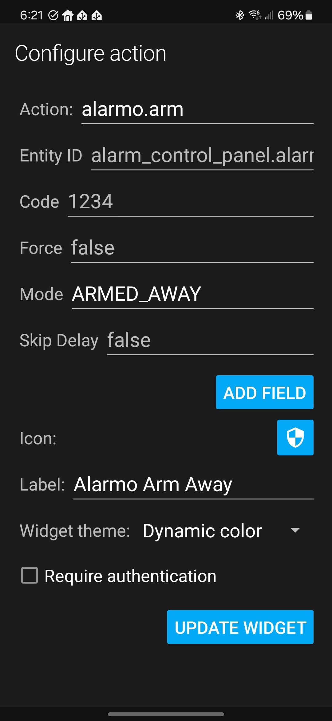

Can’t get the Android Home Assistant widget configured. The Mode doesn’t seem to arm. Any working mode?
Figured it out, the action cannot be alarmo…, needs to be alarm_control_panel. and the entity id needs to identify the alarmo system.
